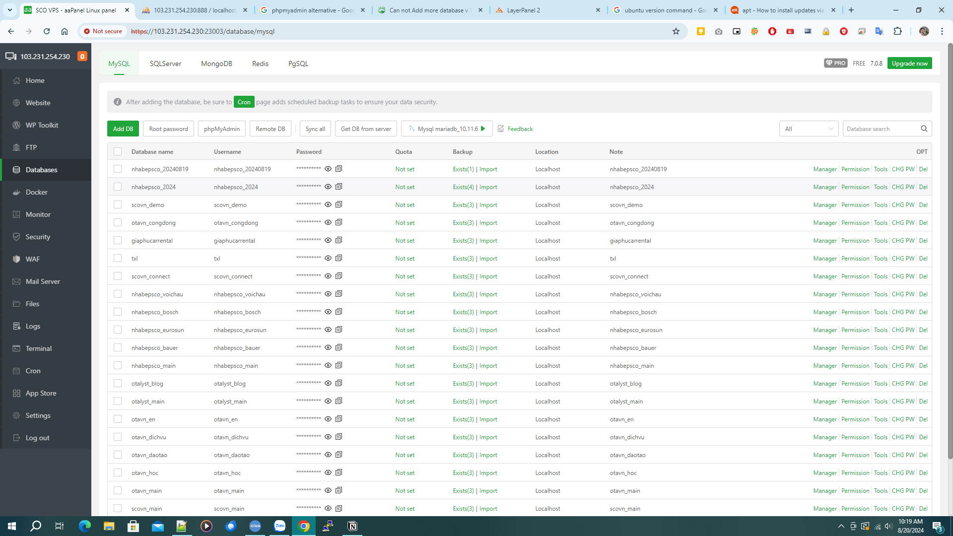

Can not Add more database v 7.0.8
Hello, would you like to check if mysql is running normally? Is it normal to try adding using phpmyadmin?
aaPanel_Kern yes, It could be add in phpmyadmin

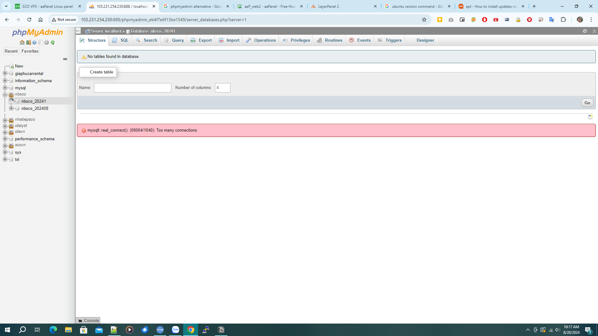

It created some databases, but It don't shown in aapanel

phpmyadmin prompts that there are too many connections, resulting in the inability to connect to mysql?
I think it means that his databases had already exceed max connection limit. Increasing max connection value at MySQL Server is needed.
