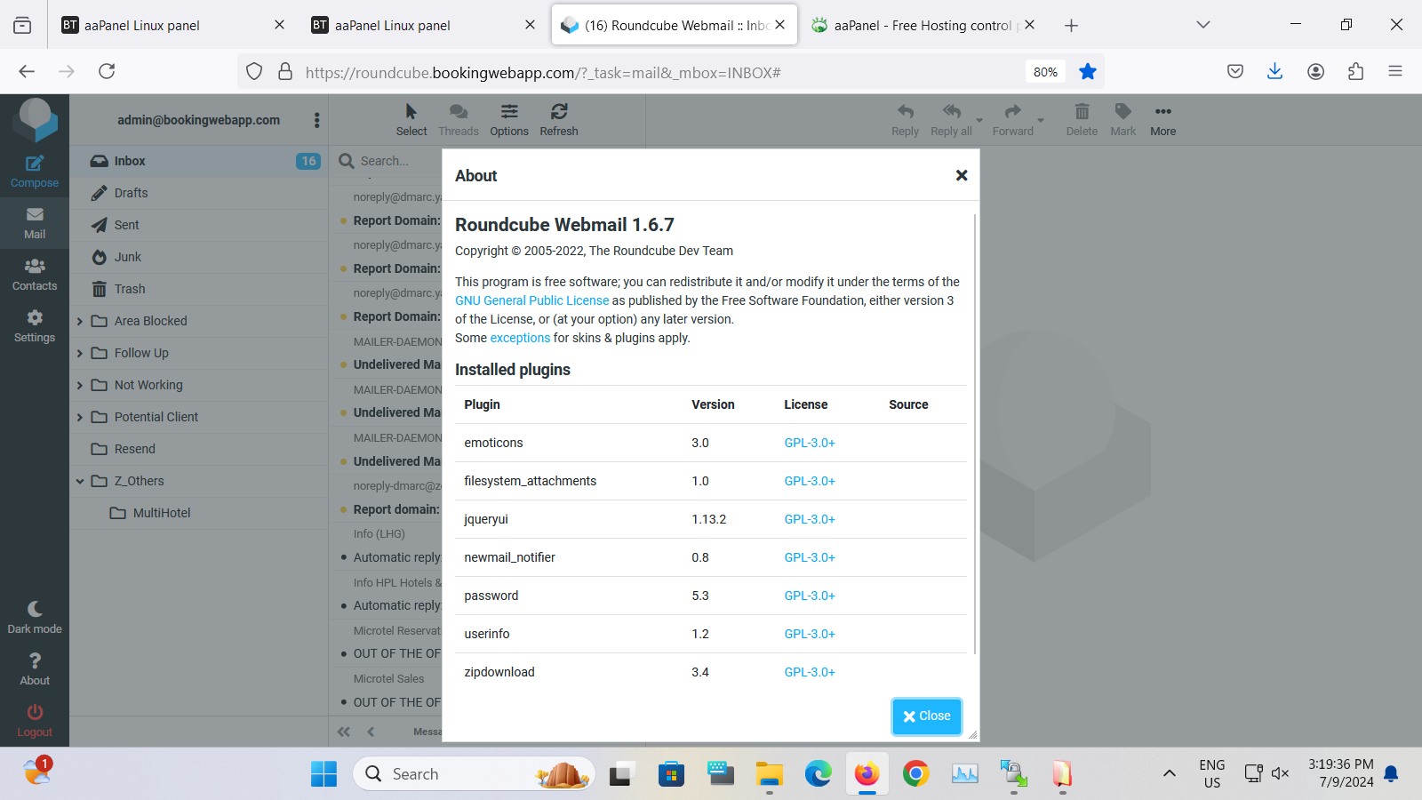

I will help you how to upgrade roundcube to the latest version and I am going to use roundcube version 1.6.7.
First backup your roundcube webfiles and roundcube database file. Then download the roundcube 1.6.7 file. I used SSH command and used wget

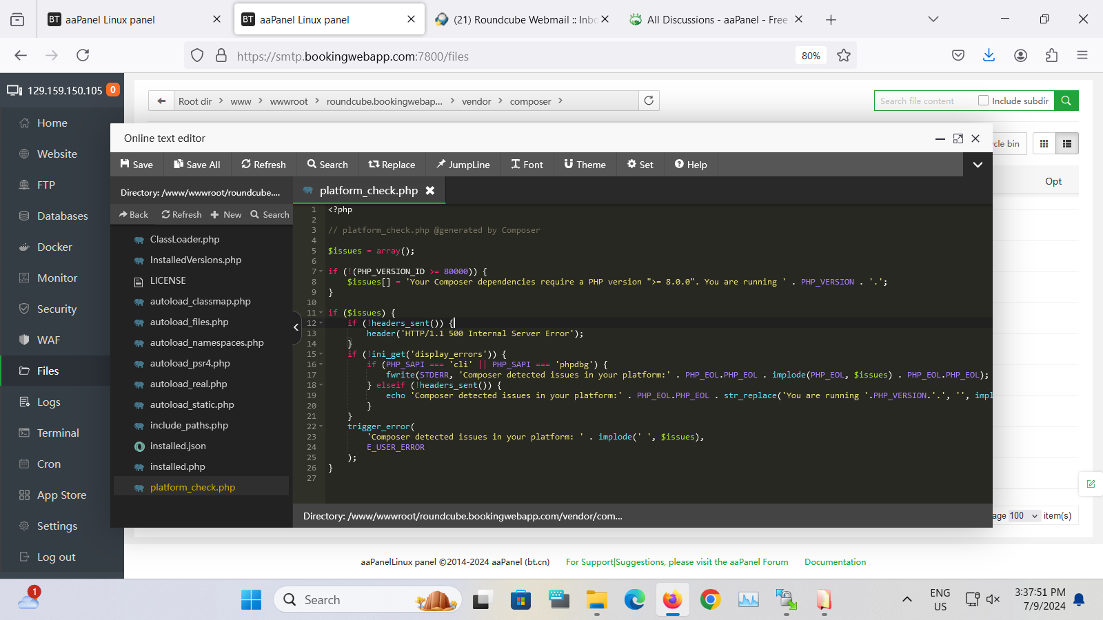

If you have problem with composer and it requires you a selected PHP version, you can modify it through editing your platform_check.php file.

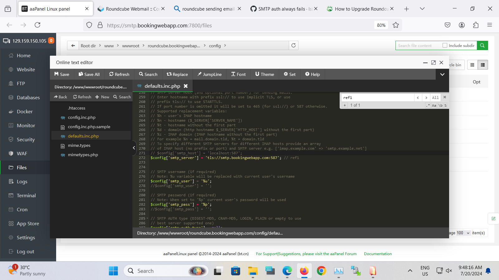

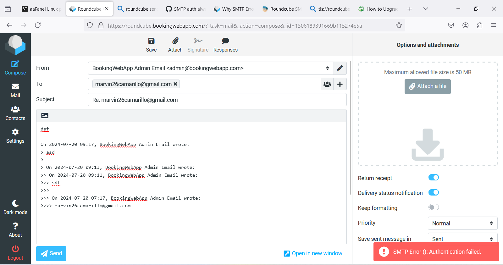

If you are having trouble and you got a SMTP error: Authentication failed, you need to modify your file in yourroundcubefolder/config/defaults.inc.php
just remove or comment the $config['smtp_host'] and put this code $config['smtp_server'] = 'tls://yourmailserverurl:587';
You can also remove the port 587.
