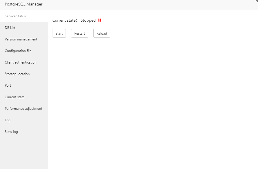

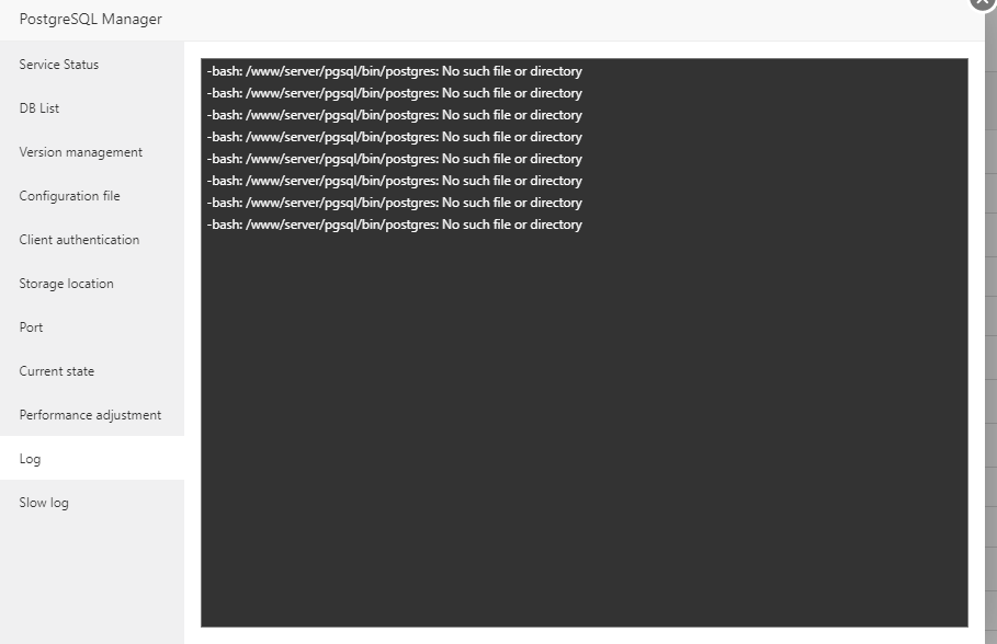

aaP_itproject_dmitry aaPanel_Kern Hi. I have this problem too. how can I solve it? reinstalling does not help.
aaP_phamngocthanh281997 aaP_itproject_dmitry setup 6.8 https://github.com/aaPanel/aaPanel , tôi thấy bản mới hầu hết không cài được
aaPanel_Kern Hello, this is an installation failure. It is recommended that you install it again. If the installation fails, it is recommended to check whether there is an error log. aaP_phamngocthanh281997 aaP_itproject_dmitry
Hieumin9802 resolve error after installed from PostgreSQL Manager plugin ex: install postgresql-16.1 check in folder /usr/local/ has folder name "postgresql-16.1" create symlink: ln -s /usr/local/postgresql-16.1 /usr/local/pgsql reopen plugin PostgreSQL Manager and try install again
