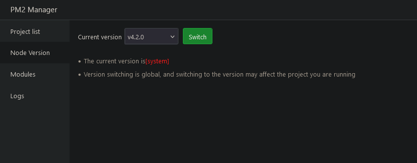

aaP_mdestafadilah_simrs Hi Kern, After minor update to v7.0.3 i change node js in PM2 manager, it's always default to v4.2.0 not select to my choice. like below
aaPanel_Kern Hello, this is caused by the unsuccessful node version installation. It is recommended that you use the node project.

aaP_mailkevin So what's the solution to getting the same version installed via Node Version Manager to appear in Pm2 as well? I have version 16.13.2 installed in Node Version Manager and I'd like that same version to appear as 'Current Version' in pm2 (instead of v4.2.0)
