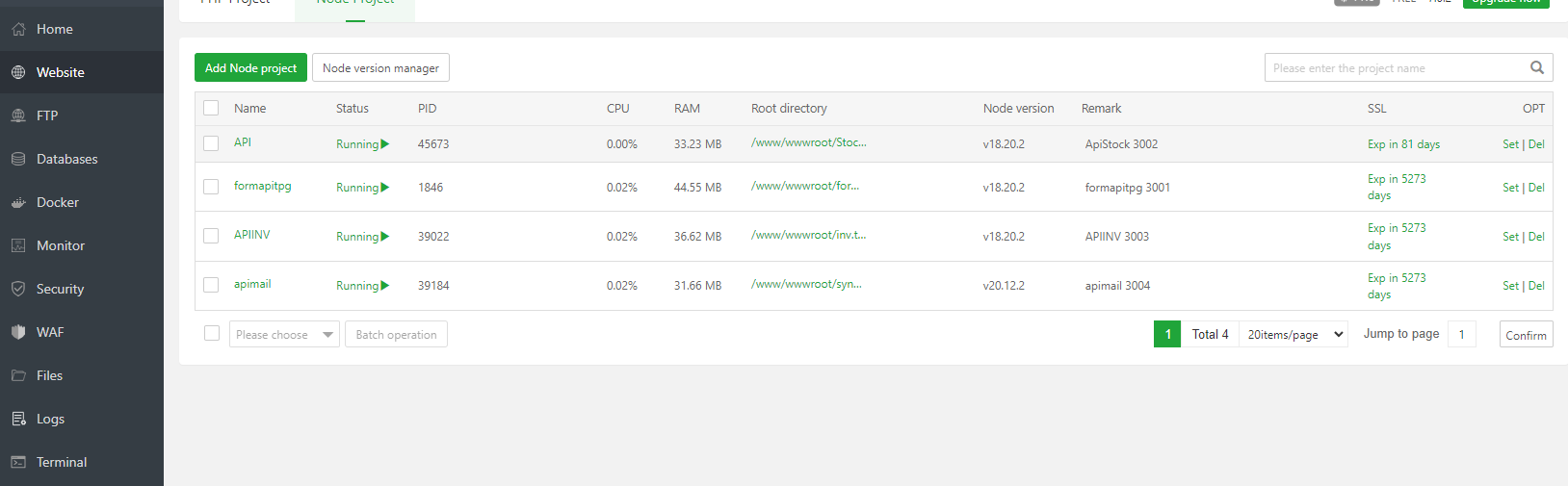

Hello, it is recommended that you use the Node project under the website
ัyes i use Node project under the website

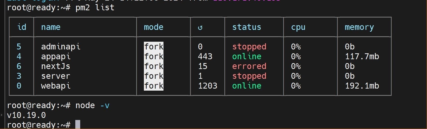

An example image of what I want to look like. But the one I installed didn't show up.
- Edited

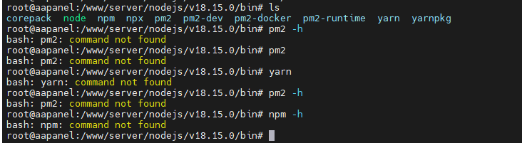

I try use full path such

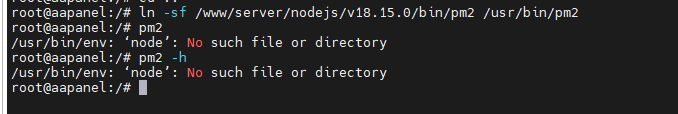

Hello, try to set up the soft link yourself
ln -sf /www/server/nodejs/v18.15.0/bin/pm2 /usr/bin/pm2
Is it possible to change pm2 to the full path?
I can't do it
