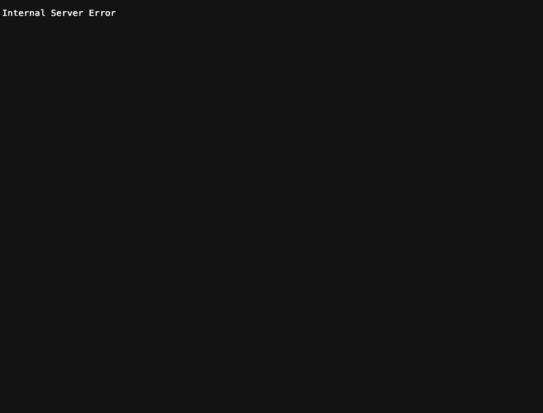

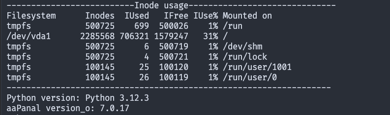

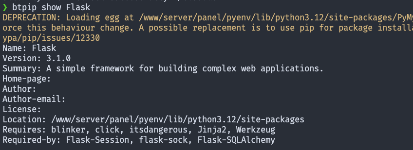

          Hi
          After update, I got an 'Internal Server Error' error page.
          I try:
          • bt 14
          • curl -k https://node.aapanel.com/install/update_7.x_en.sh | bash
          • restart my VPS
          • cancel domian binding
            Any idea?
            Hello,
            Try restarting the panel once and checking for errors, check logs: bt 1 && bt 22

            @aaPanel_Kern, Thanks for answering.
            I got the following error:
            File "/www/server/panel/pyenv/lib/python3.12/site-packages/flask/app.py", line 1454, in wsgi_app
                ctx.push()
              File "/www/server/panel/pyenv/lib/python3.12/site-packages/flask/ctx.py", line 377, in push
                self.session = session_interface.open_session(self.app, self.request)
              File "/www/server/panel/class/flask_session/sessions.py", line 233, in open_session
                sid = request.cookies.get(app.session_cookie_name)
            AttributeError: 'Flask' object has no attribute 'session_cookie_name'
                ctx.push()
              File "/www/server/panel/pyenv/lib/python3.12/site-packages/gevent/pywsgi.py", line 1107, in handle_one_response
                self.run_application()
              File "/www/server/panel/pyenv/lib/python3.12/site-packages/gevent/pywsgi.py", line 1053, in run_application
                self.result = self.application(self.environ, self.start_response)
              File "/www/server/panel/pyenv/lib/python3.12/site-packages/flask/app.py", line 1478, in __call__
                return self.wsgi_app(environ, start_response)
              File "/www/server/panel/pyenv/lib/python3.12/site-packages/flask/app.py", line 1458, in wsgi_app
                response = self.handle_exception(e)
              File "/www/server/panel/pyenv/lib/python3.12/site-packages/flask/app.py", line 810, in handle_exception
                server_error = self.ensure_sync(handler)(server_error)
              File "/www/server/panel/BTPanel/__init__.py", line 523, in error_500
                if not session.get('login', None):
            AttributeError: 'NoneType' object has no attribute 'get'
            2025-03-28T06:22:09Z {'HTTP_HOST': 'MY_VPS_IP:26121', (hidden keys: 27)} failed with AttributeError
            [2025-03-28 06:22:09,566][ERROR] - Exception on /favicon.ico [GET]
                ctx.push()
            [2025-03-28 06:22:09][DEBUG] - Traceback (most recent call last):
                ctx.push()
                ctx.push()
            2025-03-28T06:22:09Z {'HTTP_HOST': 'MY_VPS_IP:26121', (hidden keys: 26)} failed with AttributeError

              Detailed problem description:
              I think the error ouccur because somehow I upgrade Flask version from 2xx to 3.xx and in the new version app.session_cookie_name removed.
                Hello, is the problem solved?
                Is it normal to try to install Flask 2.2.5 version?
                Or delete pyenv and repair the panel?
                mv /www/server/panel/pyenv /www/server/panel/pyenv_bak
                rm -f /tmp/update_to7.pl && curl -k https://node.aapanel.com/install/update_7.x_en.sh | bash
