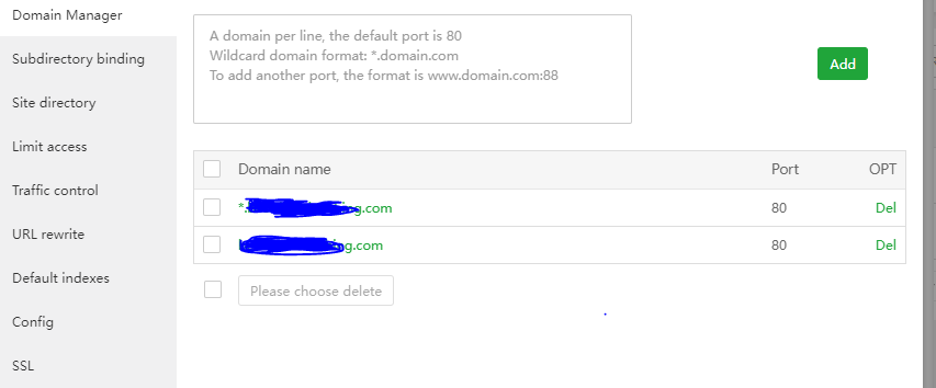

Hi, I'm new to aapanel and having difficulties with let's encrypt ssl on my wildcard domains.
mydomain.com
*.mydomain.com
The above is how I added my domain and the wildcard in the domain manager.
But when I visit my wildcard domain like test.mydomain.com I noticed that the ssl is not activated but the main domain is fully activated and working.

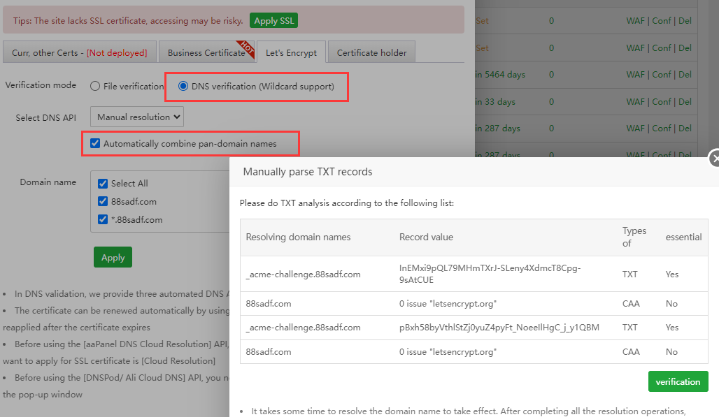

    Hello, does the SSL certificate you use include *.mydomain.com?
    If it is not *.mydomain.com, please apply for a pan-domain name certificate. You need to apply using DNS.

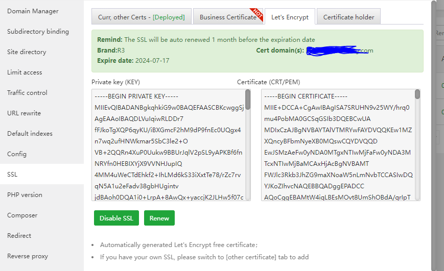

    I'm not sure if it includes *.mydomain.com, I'm using the let's encrypt ssl from aapanel.

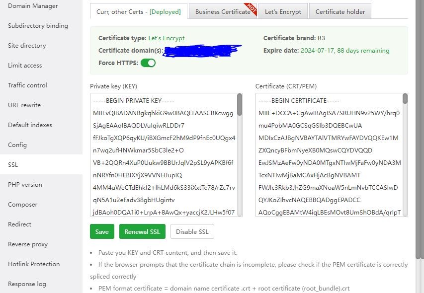

    I followed the normal step of adding domain and checking the Apply for SSL and HTTP redirect to HTTPS box.
    Domain and Wildcard Image
    SSL Image
    How can I apply for a pan-domain name certificate?
    Where can I locate my DNS in aapanel?
      I can't find this on my panel, am using the current aapanel version and apache installed
      Let's Encrypt Image... No option for DNS verification
        Thanks for your support, It's working fine now.
