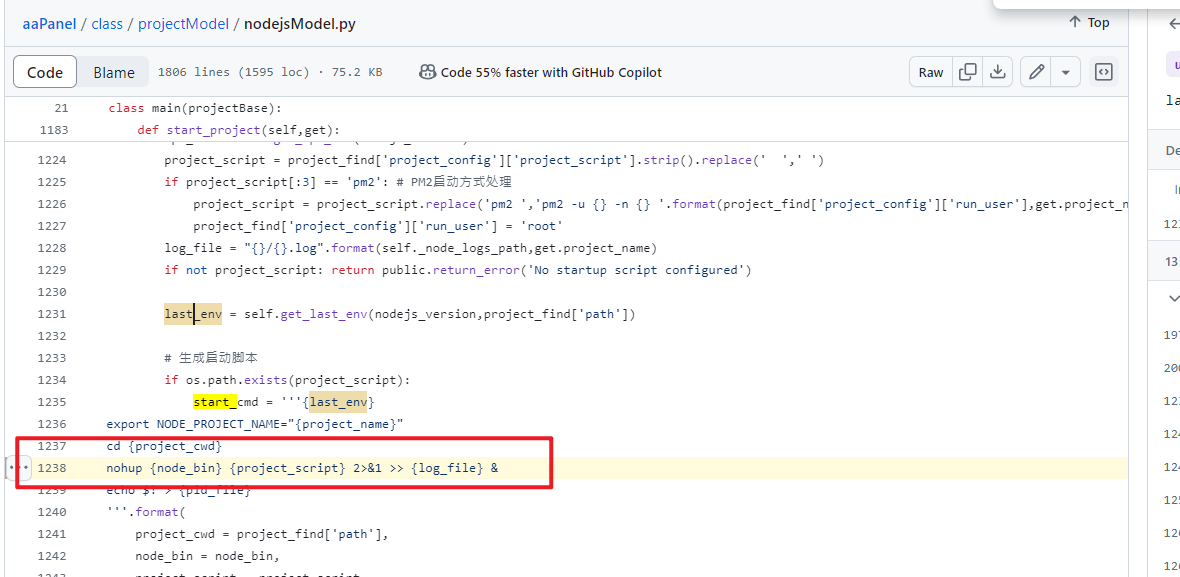

https://github.com/aaPanel/aaPanel/blob/master/class/projectModel/nodejsModel.py#L1238
Regarding the code snippet in the specified location of aaPanel, nohup {node_bin} {project_script} 2>&1 >> {log_file} &, it was observed that on Ubuntu 20.04, stderr is not being appended to log_file. However, changing it to nohup {node_bin} {project_script} >> {log_file} 2>&1 & allows stderr to be appended to log_file.
I'd like to inquire whether this issue is due to the operating system or if it can be corrected by modifying the source code.
