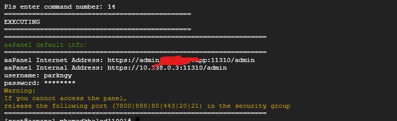

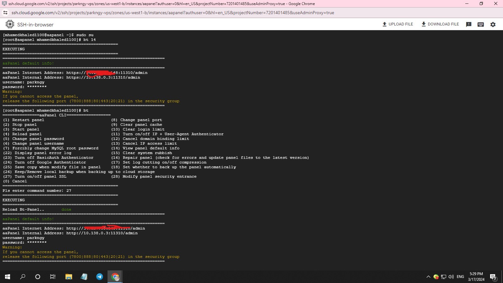

I changed the control panel link to another link and it did not work. I typed the command bt 12 to cancel domain binding limit and return to the default link and it did not work!!
    Hello, is it possible to try to cancel the IP access limit bt 13? Try modifying the security entrance, or is it normal to use the browser to access in incognito mode?

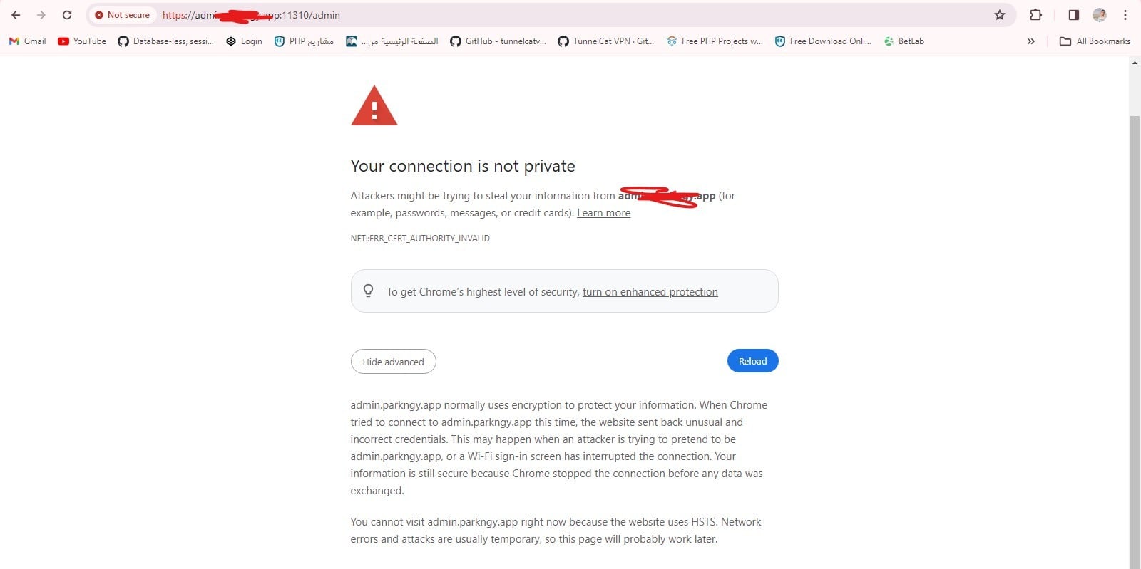

    Thanks, I opened it, but I changed the admin panel domain again and this error appears

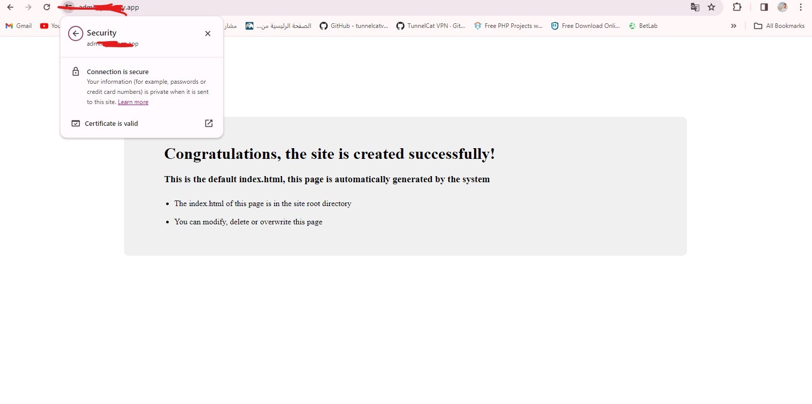

    Please note that the site has an SSL certificate as shown
      Hello, this is because the domain name used by the website and the panel is the same main domain name, but the certificate of the panel does not match the domain name. It is recommended that you cancel the domain name binding first and use IP access.
      If you need to use a domain name, please configure the matching certificate in the panel settings.

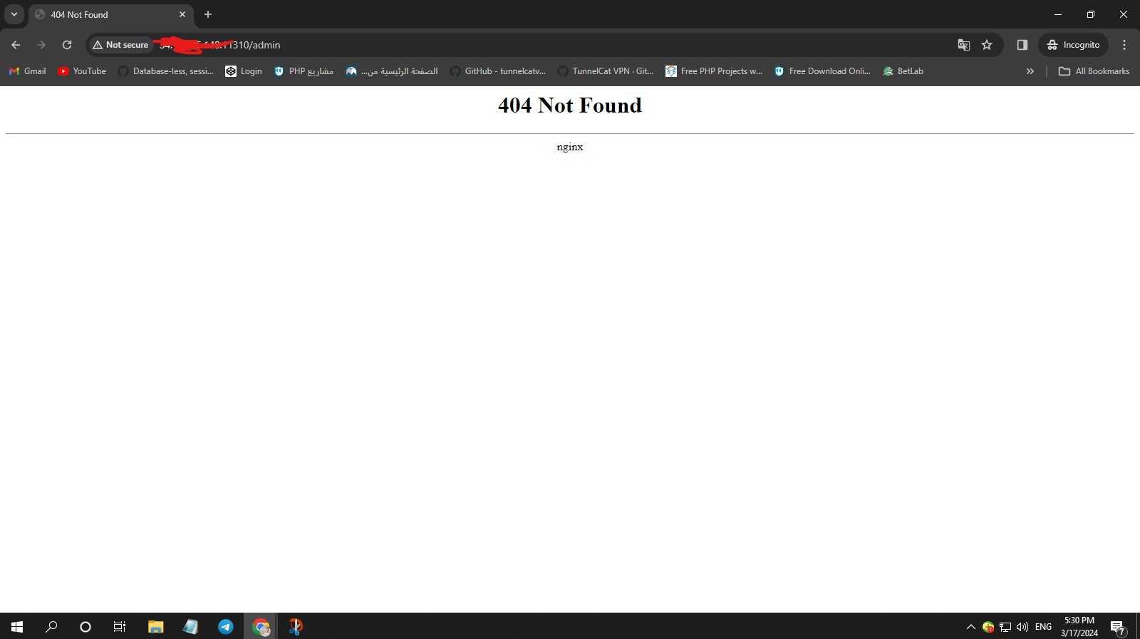

      The cache can be a problem, always use incognito mode
      Close the browser and try again after doing step 13 to first address the domain in the DNS for the IP (without proxies, direct) and then enable SSL using lets encrypt or some other
