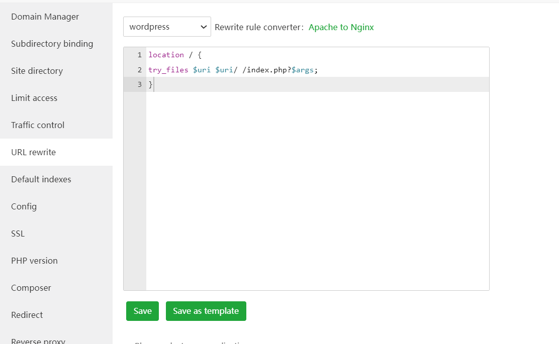

Put these code to Nginx Rewrite rule file and save.
location / {
try_files $uri $uri/ /index.php?$args;
Note: For Nginx Website Server Only

    Hello, is it possible to try to modify the permanent link in the background of the website?

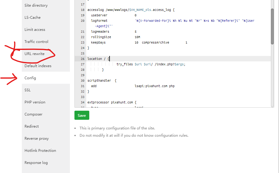

    Just Add it on Config not URL rewrite
    location / {try_files $uri $uri/ /index.php?$args;}

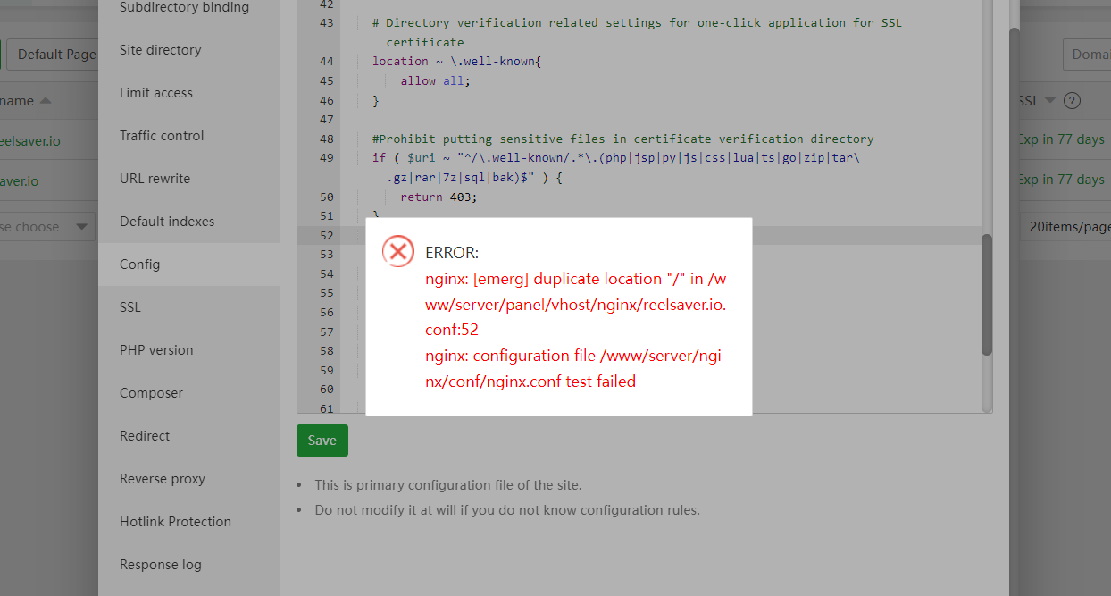

    Hello, would you like to add the content of line 52? Please check whether the configuration of the relevant site is configured correctly.

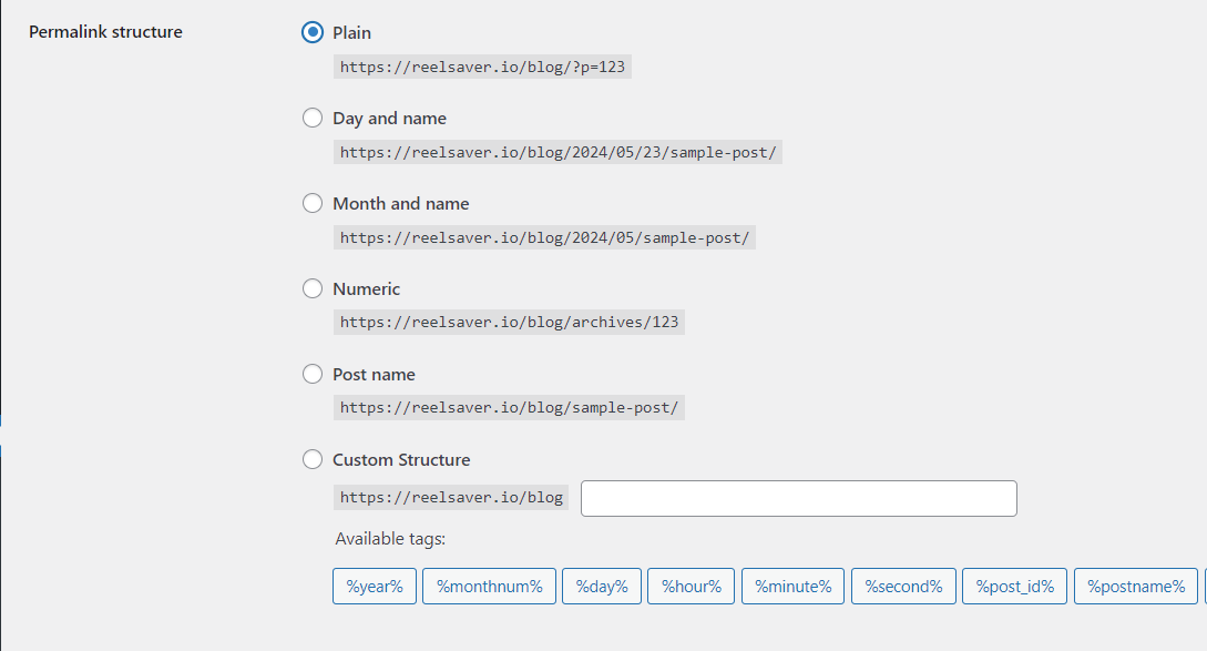

    Hi, I have checked, when I choose plain in the permalink then its working fine and when I choose post name then getting same error - Publishing failed. The response is not a valid JSON response.
