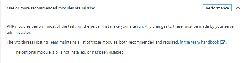

i solved all the issue now but
this is still here
how to solve this issue
this is still here
Hello, I suggest you check if the zip extension is installed? Are there duplicate zip.so configurations?

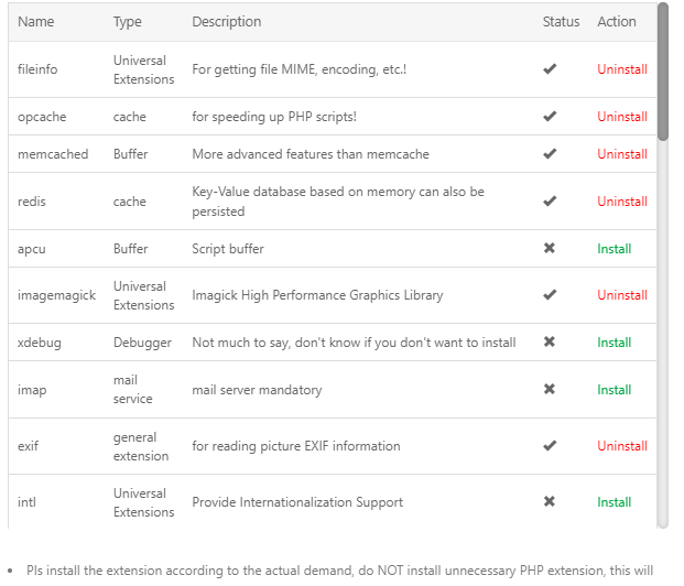

I solved it by doing this:
Install imagemagick first then fileinfo and finally install mbstring.
In the latest 8.3 PHP version of aapanel, you can't install mbstring without installing imagemagick and fileinfo first.
Thanks to @aaP_hk2263247

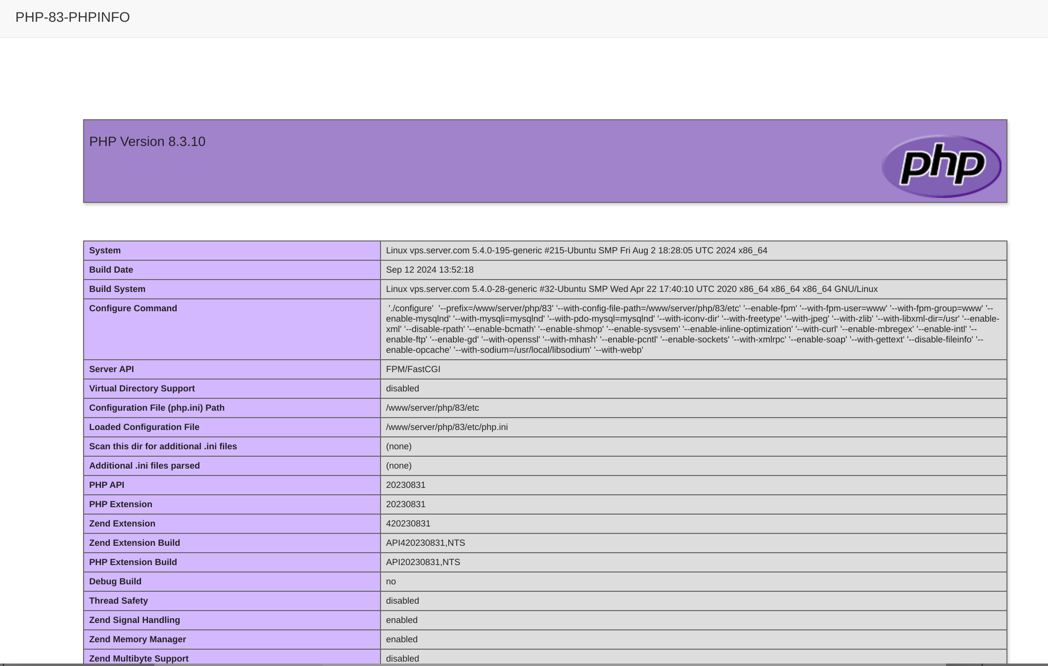

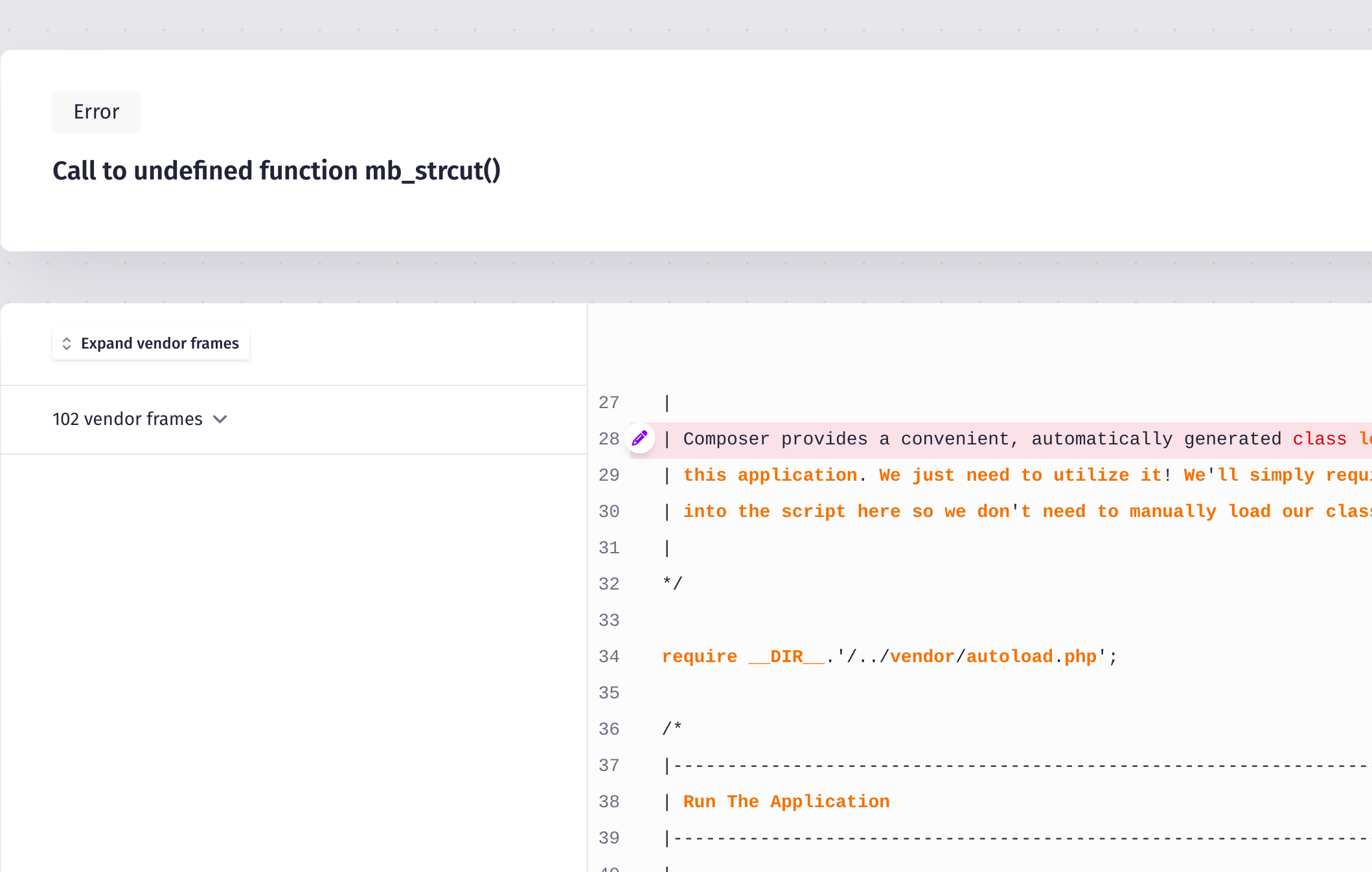

hi team, can you help me about this?
Aapanel showing PHP 8.3.12 with some extension but phpinfo() show different
the result is in my laravel app, showing error mb_strcut() which is with extension mbstring (that already installed in aapanel, but when in app & phpinfo it doesnt installed yet
try install mbstring
aaP_yorunairu
its installed already in aapanel, but in phpinfo showing different. no mbrstring showed and show 8.3.10 instead not 8.3.12 same as aapanel info
