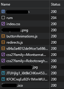

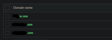

aaP_redvulcan74 I have a main domain were i have all the website files, the website works perfectly on the main domain But on the other domains some files are giving 404 error, it's the same website and files so i don't know why shows 404 on some files randomly, this is the comparison with the main domain and the other domains
aaPanel_Kern Hello, it is recommended that you directly access the link with 404 error. Is it normal? Are the access protocols used consistent? Does the website program support access from multiple domain names? aaP_redvulcan74
aaP_redvulcan74 aaPanel_Kern Sorry for the time waste, I forgot the hotlink protection, thanks for your time
