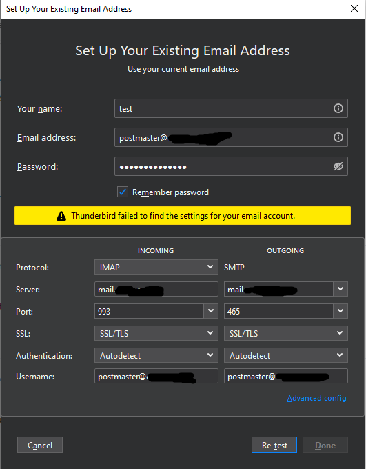

I tested to a new server with fresh installation and I have the same result. I have all mail ports open and 465 and 993 not connected from thunderbird and other smtp testers. Maybe its a bug in version 3.3, OpenSSL may not working correct. I install DNS manager, same.

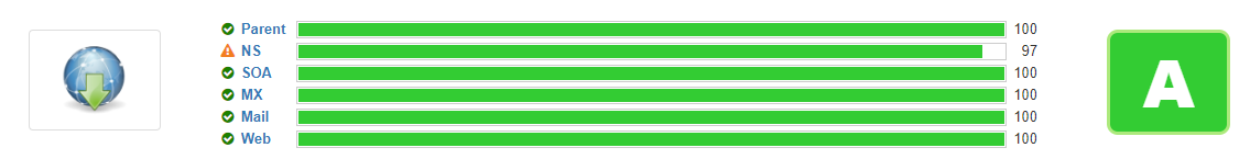

    Jimmy how do you make the connection? TLS? Are you accepting all certificates? Can you provide a DNS Inspection over your domain name were you are facing this problem?
    https://dnsinspect.com
    If you can create a report and paste the result here we would have more data, just to check if your DNS records are correct or not.

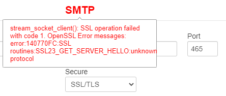

        I do it but I have this error on rainloop:
        IMAPs port (993) works ok.
        Certificate is Let's encrypt
          STARTTLS works ok with the lets encrypt SSL but SSL/TLS option not.
            In Rainloop all ports works except 465 for SMTP.
            For Incoming none (143), STARTTLS (143), SSL/TLS (993) : Works all
            For outgoing: none (25), STARTTLS (587) : works
            SSL/TLS (465) not work.

                Instead of Autodetect, please select Account Details. You should avoid autodetect settings always.

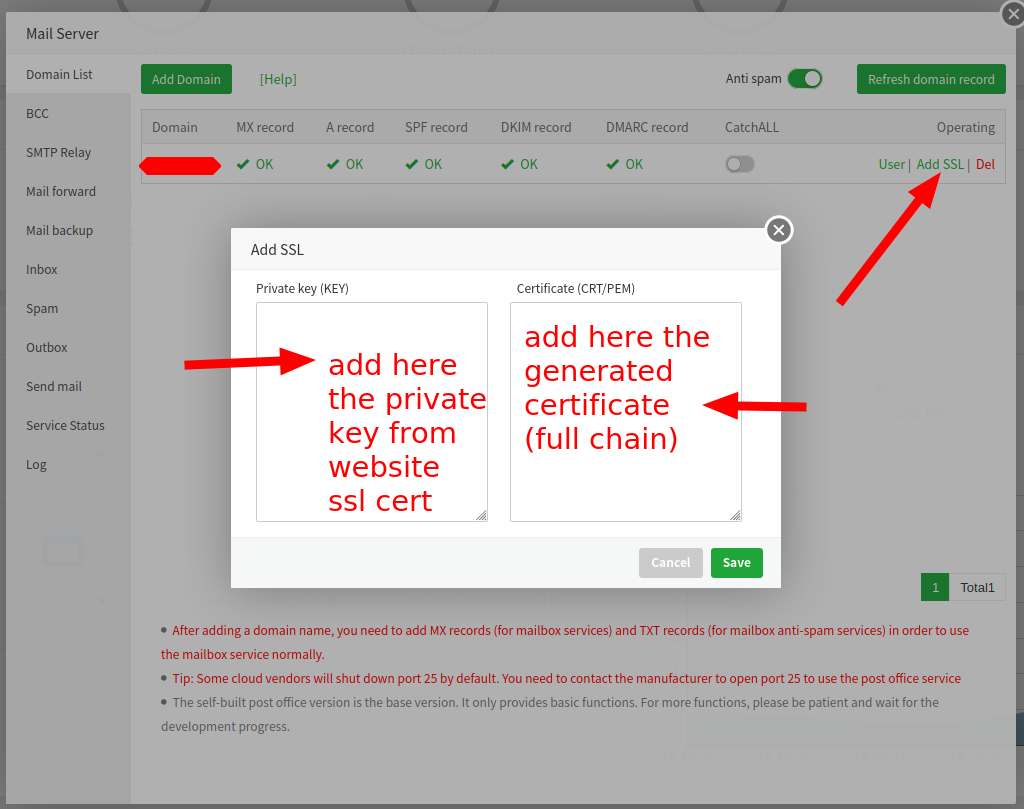

                • I created a website mail.domain.com to automatically generated SSL certificate
                • once complited it generate :
                    1 key
                    1 certificate (not full chain)

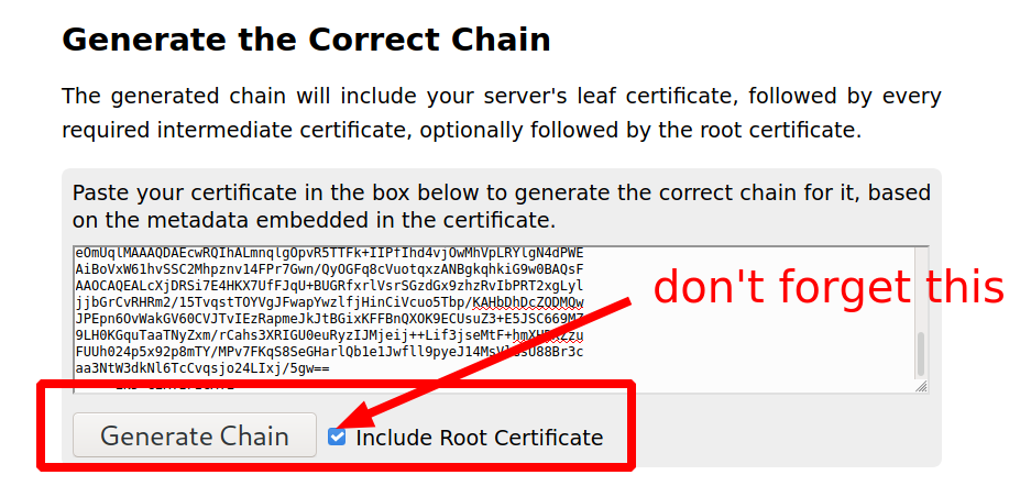

                then I would go to https://whatsmychaincert.com to check my certificate,
                • I copy past website certificate and generate full chain with root cert
                • I get the generated valid cert and added to my postfix config

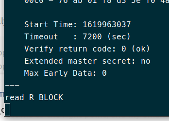

                • finally i test with openssl 😀
                   openssl s_client -connect mail.domain.com:465
                   openssl s_client -connect mail.domain.com:993
                   openssl s_client -starttls smtp -connect mail.domain.com:587
                and all test get me to the right point, and my email client works fine
