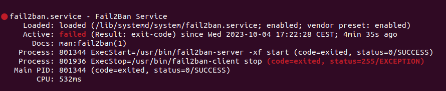

I've added customized rules from the command line in /etc/fail2ban/jail.local. According to the /var/log/fail2ban.log the customized jail was created correctly. However, querying the fail2ban status with systemctl status fail2ban
returns a failed.
Below is the following error:
ERROR Failed to access socket path: /www/server/panel/plugin/fail2ban/fail2ban/fail2ban.sock. Is fail2ban running?

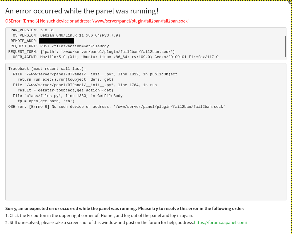

From the aaPanel admin panel everything seems to work correctly. After trying to browse the fail2ban.sock file from the aaPanel file explorer, the following error is displayed:
