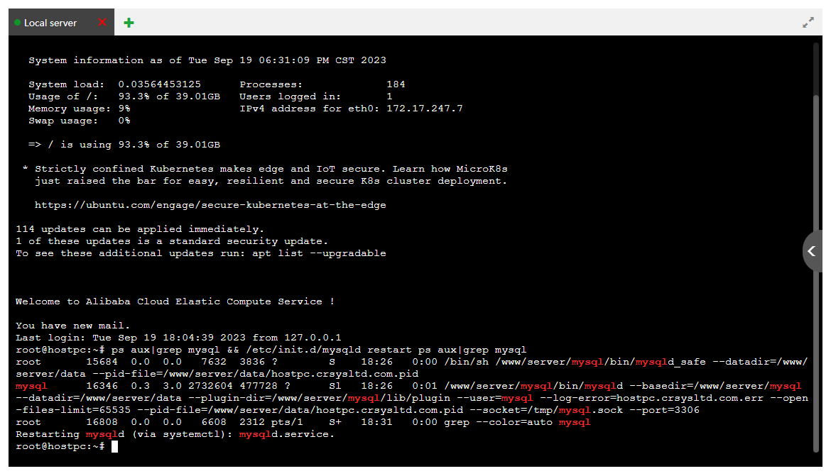

aaPanel_Kern aaP_tommychan_ckw Check if mysql is running ps aux|grep mysql && /etc/init.d/mysqld status If it does not start try starting it manually /etc/init.d/mysqld start
aaPanel_Kern aaP_tommychan_ckw Is it normal to try restarting mysql? ps aux|grep mysql && /etc/init.d/mysqld restart Also check if the process pid has changed? ps aux|grep mysql Do you have multiple mysql in your system?
aaPanel_Kern aaP_tommychan_ckw Please execute the commands separately to check whether the PID of the process has changed.
aaPanel_Kern Hello, the table space is damaged. After taking a snapshot of the server, solve it according to the tutorial. https://dev.mysql.com/doc/refman/8.0/en/forcing-innodb-recovery.html https://www.aapanel.com/forum/d/13216-mysqlmariadb-innodb-storage-engine-damage-solution aaP_tommychan_ckw
