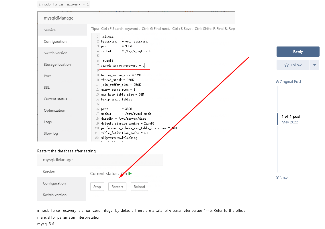

mysql can't run, here is the log
2023-07-22 7:11:16 0 [Note] InnoDB: Mutexes and rw_locks use GCC atomic builtins
2023-07-22 7:11:16 0 [Note] InnoDB: Uses event mutexes
2023-07-22 7:11:16 0 [Note] InnoDB: Compressed tables use zlib 1.2.11
2023-07-22 7:11:16 0 [Note] InnoDB: Number of pools: 1
2023-07-22 7:11:16 0 [Note] InnoDB: Using generic crc32 instructions
2023-07-22 7:11:16 0 [Note] mysqld: O_TMPFILE is not supported on /tmp (disabling future attempts)
2023-07-22 7:11:16 0 [Note] InnoDB: Initializing buffer pool, total size = 4G, instances = 8, chunk size = 128M
2023-07-22 7:11:16 0 [Note] InnoDB: Completed initialization of buffer pool
2023-07-22 7:11:16 0 [Note] InnoDB: If the mysqld execution user is authorized, page cleaner thread priority can be changed. See the man page of setpriority().
2023-07-22 7:11:16 0 [Note] InnoDB: Starting crash recovery from checkpoint LSN=43192320976
2023-07-22 7:11:17 0 [Note] InnoDB: Transaction 49826004 was in the XA prepared state.
2023-07-22 7:11:17 0 [Note] InnoDB: 1 transaction(s) which must be rolled back or cleaned up in total 0 row operations to undo
2023-07-22 7:11:17 0 [Note] InnoDB: Trx id counter is 49826005
2023-07-22 7:11:17 0 [Note] InnoDB: Starting final batch to recover 22 pages from redo log.
2023-07-22 07:11:17 0x153a829f4700 InnoDB: Assertion failure in file /home/baota/deb/mariadb/mariadb104/bt-mariadb104-10.4.14/storage/innobase/log/log0recv.cc line 1519
InnoDB: Failing assertion: !page || (ibool)!!page_is_comp(page) == dict_table_is_comp(index->table)
InnoDB: We intentionally generate a memory trap.
InnoDB: Submit a detailed bug report to https://jira.mariadb.org/
InnoDB: If you get repeated assertion failures or crashes, even
InnoDB: immediately after the mysqld startup, there may be
InnoDB: corruption in the InnoDB tablespace. Please refer to
InnoDB: https://mariadb.com/kb/en/library/innodb-recovery-modes/
InnoDB: about forcing recovery.
230722 7:11:17 [ERROR] mysqld got signal 6 ;
This could be because you hit a bug. It is also possible that this binary
or one of the libraries it was linked against is corrupt, improperly built,
or misconfigured. This error can also be caused by malfunctioning hardware.
To report this bug, see https://mariadb.com/kb/en/reporting-bugs
We will try our best to scrape up some info that will hopefully help
diagnose the problem, but since we have already crashed,
something is definitely wrong and this may fail.
Server version: 10.4.14-MariaDB-log
key_buffer_size=1073741824
read_buffer_size=16777216
max_used_connections=0
max_threads=502
thread_count=0
It is possible that mysqld could use up to
key_buffer_size + (read_buffer_size + sort_buffer_size)*max_threads = 17511500 K bytes of memory
Hope that's ok; if not, decrease some variables in the equation.
Thread pointer: 0x0
Attempting backtrace. You can use the following information to find out
where mysqld died. If you see no messages after this, something went
terribly wrong...
stack_bottom = 0x0 thread_stack 0x49000
/www/server/mysql/bin/mysqld(my_print_stacktrace+0x2d)[0x559c88f0e66d]
/www/server/mysql/bin/mysqld(handle_fatal_signal+0x54d)[0x559c88a4982d]
/lib/x86_64-linux-gnu/libpthread.so.0(+0x143c0)[0x153c6529f3c0]
/lib/x86_64-linux-gnu/libc.so.6(gsignal+0xcb)[0x153c64a1d03b]
/lib/x86_64-linux-gnu/libc.so.6(abort+0x12b)[0x153c649fc859]
/www/server/mysql/bin/mysqld(+0x5a5f2f)[0x559c88746f2f]
/www/server/mysql/bin/mysqld(+0x589845)[0x559c8872a845]
/www/server/mysql/bin/mysqld(+0xab07af)[0x559c88c517af]
/www/server/mysql/bin/mysqld(+0x589c38)[0x559c8872ac38]
/www/server/mysql/bin/mysqld(+0x5ac87b)[0x559c8874d87b]
/www/server/mysql/bin/mysqld(+0xbef7be)[0x559c88d907be]
/www/server/mysql/bin/mysqld(+0xb349b8)[0x559c88cd59b8]
/lib/x86_64-linux-gnu/libpthread.so.0(+0x8609)[0x153c65293609]
/lib/x86_64-linux-gnu/libc.so.6(clone+0x43)[0x153c64af9163]
The manual page at https://mariadb.com/kb/en/how-to-produce-a-full-stack-trace-for-mysqld/ contains
information that should help you find out what is causing the crash.
Writing a core file...
Working directory at /www/server/data
Resource Limits:
Fatal signal 11 while backtracing
