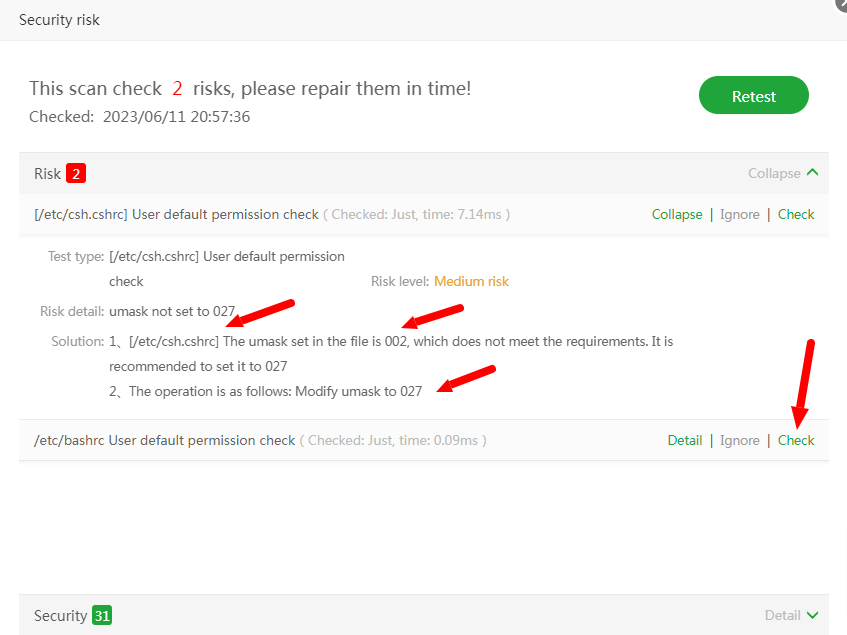

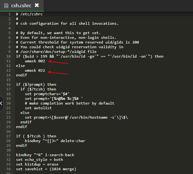

        Rocky Linux release 8.8 (Green Obsidian)
        This scan checks 2 risks, fix them in time!
        Please explain well since when I modify the status does not change to security.
        I have restarted the server and nothing.
          elite
          Hi, thanks for your feedback, this is a known issue. Just ignore it after changing

            Hi, after updating from 6.8.27 to 6.8.28 (with Debian 11), I get these 5 security issues:
            • Critical file permission checks
              Test type: Critical file permission checks
              Risk level: High risk
              Risk detail: The following critical files or directories have permission errors:
              /etc/shadow Current permissions: 640 : root Suggested changes to: 400 : root
              /etc/security Current permissions: 755 : root Suggested changes to: 600 : root
              /etc/gshadow Current permissions: 640 : root Suggested changes to: 400 : root
              Solution: 1、On the [File] page, set the correct permissions and owner for the specified directory or file
            • SSH idle timeout detection
              Test type: SSH idle timeout detection
              Risk level: Medium risk
              Risk detail: The current SSH idle timeout time is: 0, it is recommended to set it to 300-900
              Solution: 1、Set [ClientAliveInterval] in the [/etc/ssh/sshd_config] file to be between 600 and 900
              2、Tip: The recommended SSH idle timeout time is: 600-900
            • SSH connection attempts
              Test type: SSH connection attempts
              Risk detail: The current maximum number of SSH connections is: 6, please set it to 3-5
              Solution: 1、Set [MaxAuthTries] to 3-5 in the [/etc/ssh/sshd_config] file
              2、Tips: Set [MaxAuthTries] to 3-5 in the [/etc/ssh/sshd_config] file
            • Panel login alarm
              Test type: Panel login alarm
              Risk detail: Please enable it in [Settings] - [Notification]
              Solution: 1、Enable it in [Settings] - [Notification]
            • The panel is not monitoring
              Test type: The panel is not monitoring
              Risk level: Low risk
              Risk detail: Open it in [Monitor] - [System Monitor]
              Solution: 1、Open it in [Monitor] - [System Monitor]
            Thanks in advance
