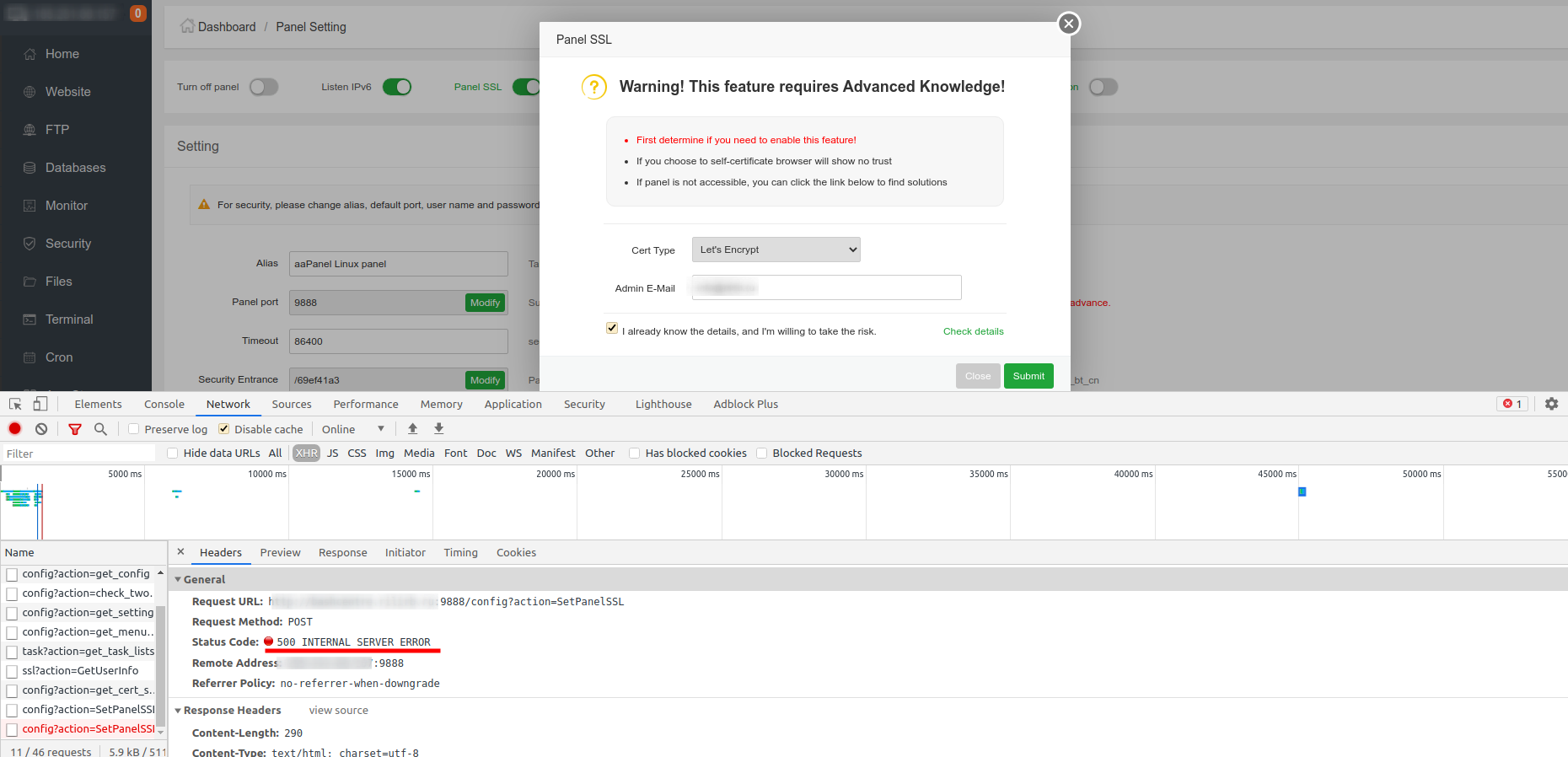

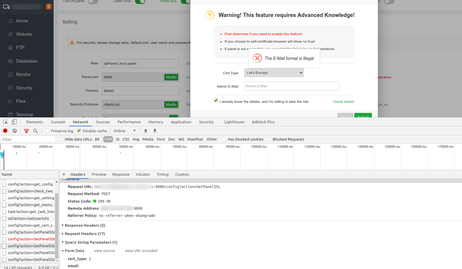

          It seems the problem is deeper. If I send the form without an email, it works. But shows a validation error.
          If the form have an email address, the request is error 500.

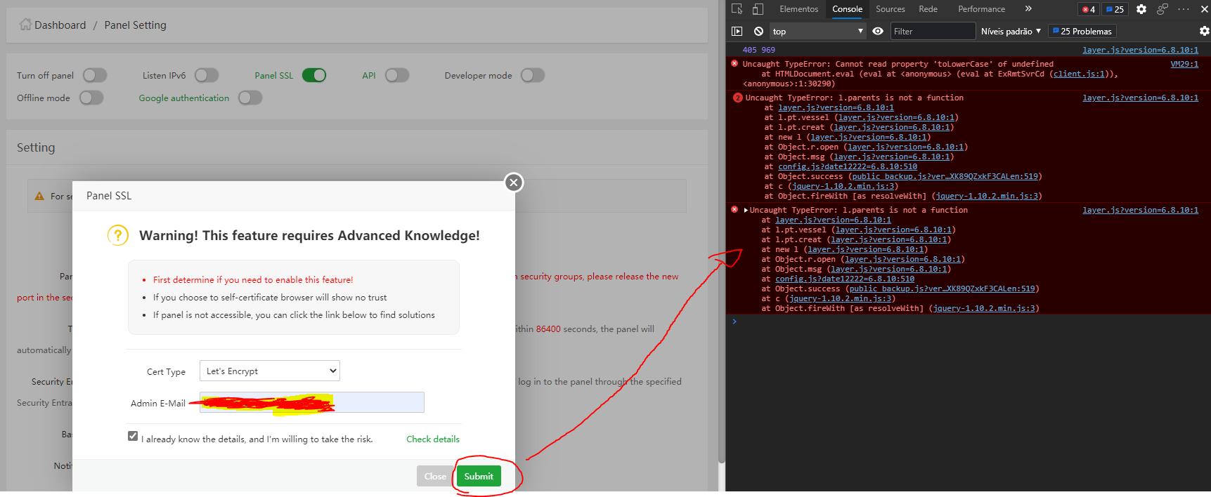

            Maybe I have same problem, button action don't work (Edge Browser)

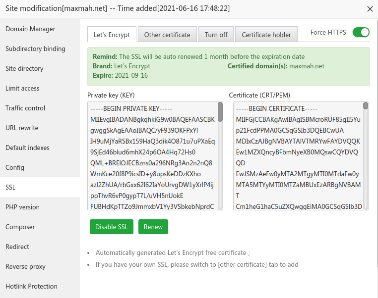

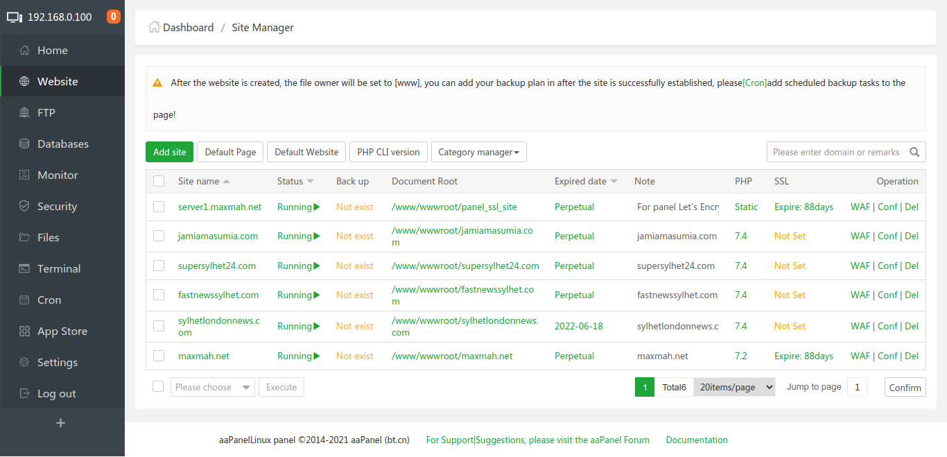

              Hi
              I am very satisfied by the performance of aaPanel and its features. I am loving it. I have enabled Lets Encrypt SSL certificate for my server panel and successfully executed it. I applied the SSL for my domain and it also successfully executed but the problem is I cant access my site by using http://maxmah.net or https://maxmah.net. What am I missing here. Could you please suggest me as early as possible.
              This site can’t be reached maxmah.net refused to connect.

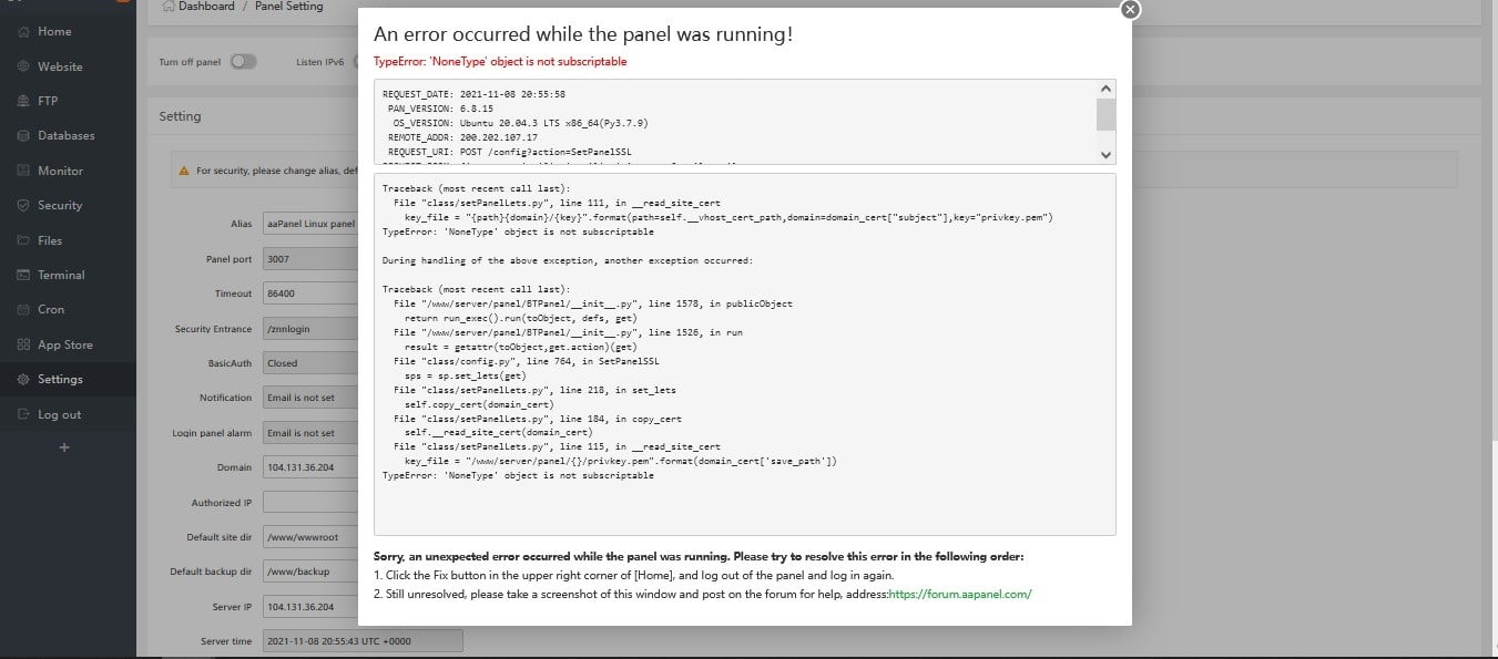

                I got "Type error: nonetype objetct is not subcriptable"
                already tried to change aapanel port and didn't work.
                already tried fix button and didn't work.

                I am also getting same Type error: nonetype objetct is not subcriptable while applying panel ssl certificate
