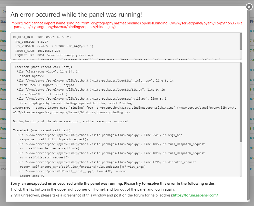

Sorry, an unexpected error occurred while the panel was running. Please try to resolve this error in the following order:
- Click the Fix button in the upper right corner of [Home], and log out of the panel and log in again.
shajal
Hello, is it normal to use the ssh tool to execute the command and try again?
mv /www/server/panel/pyenv/lib/python3.7/site-packages/OpenSSL /tmp/OpenSSL_bak
btpip install pyOpenSSL
bt reload
