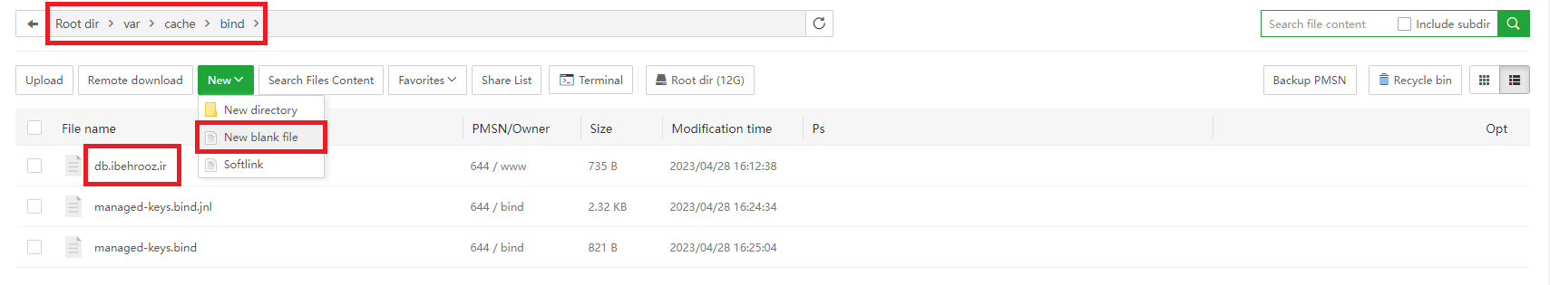

3 - open (files) from panel and then type (/var/cache/bind
) to navigate there.

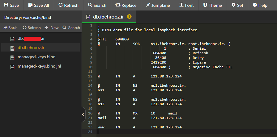

Note 1 : create a file and file name must be like db.ibehrooz.ir format and copy below contents into it .
Note 2 : replace your domain name instead of ibehrooz.ir and 121.80.123.124 instead of your server ip .
Note 3 : make sure there is a new empty line in the end of file (look at line 24 in the picture).
Note 4 : if you have another domain, just make a new file like this format in /var/cache/bind
directory and fill it with your own website info .
file content is:
; BIND data file for local loopback interface
$TTL 604800
@ IN SOA ns1.ibehrooz.ir. root.ibehrooz.ir. (
1 ; Serial
604800 ; Refresh
86400 ; Retry
2419200 ; Expire
604800 ) ; Negative Cache TTL
@ IN A 121.80.123.124
@ IN NS ns1.ibehrooz.ir.
ns1 IN A 121.80.123.124
@ IN NS ns2.ibehrooz.ir.
ns2 IN A 121.80.123.124
@ IN MX 10 mail
mail IN A 121.80.123.124
www IN A 121.80.123.124

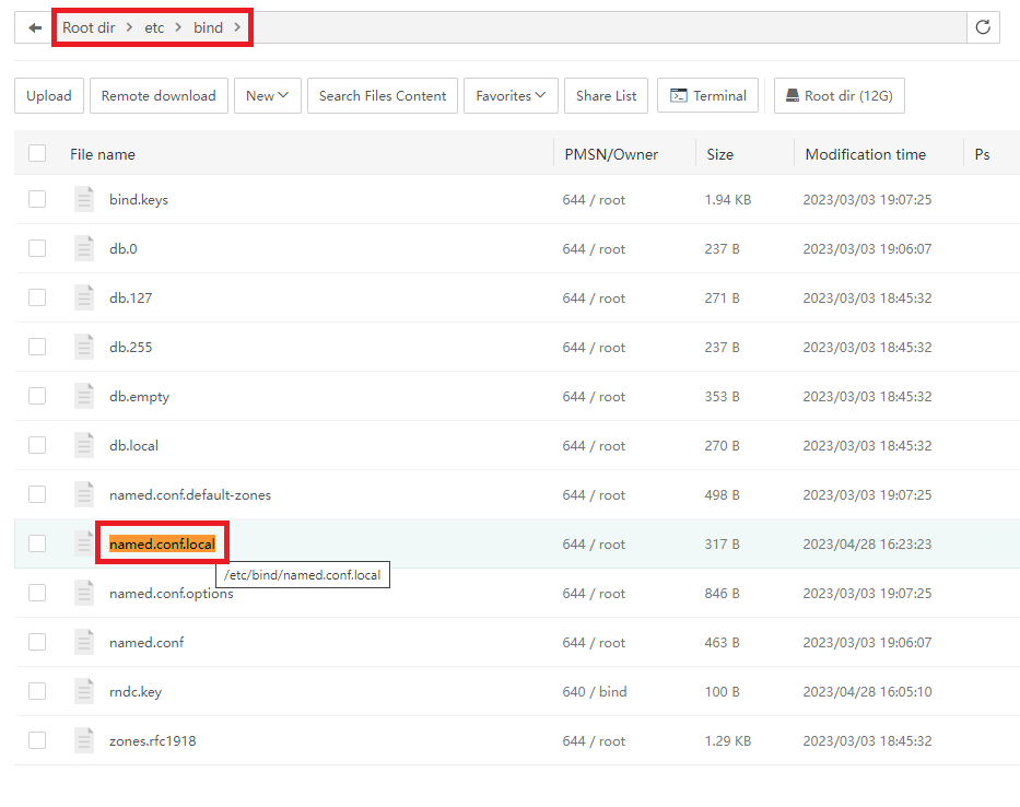

4 - open (files) from panel and then type (/etc/bind/
) to navigate this directory and open named.conf.local file.
Note 1 : open named.conf.local and copy below contents into it .
Note 4 : if you have another domain, just make a new zone for it .
