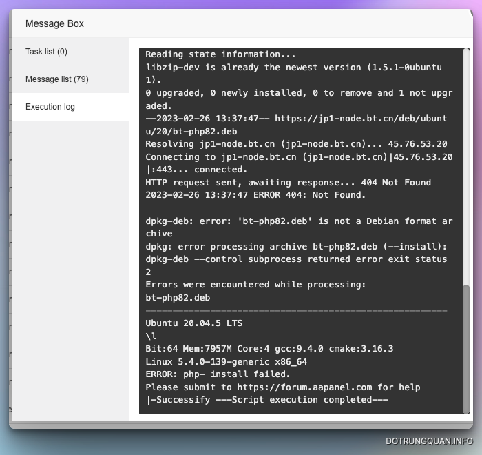

I do install PHP 8.2 from AAPANEL control panel but get little error. Please support me
PHP 8.2 install ERROR

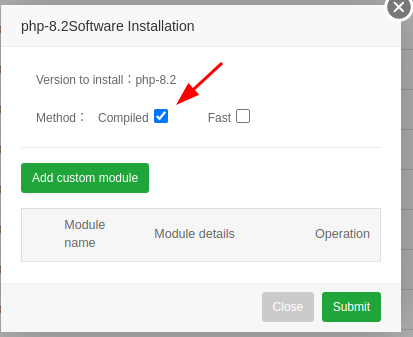

try to install as below
ByEzel Thank you. I have installed it successfully.
