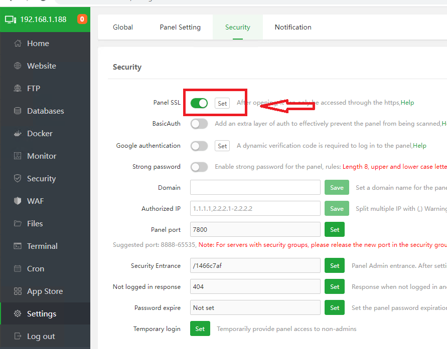

I cant access my aapanel after click off button on Panel SSL
Please help me..

    Hello, after turning off Panel SSL, you need to use http to access the panel. Links can be viewed with the command bt 14
    It is recommended to change the browser or use the incognito mode to visit

      aaPanel_Kern Thanks for help.
      But for me still insecure after follow intruction.
      And i try use Let Encrypt, But need to bind domain
      My aapanel cant open after bind domain.
        aaP_azuy_me
        Turn on panel SSL and use a self-signed certificate. It is also encrypted. Then the browser imports the trust certificate file
