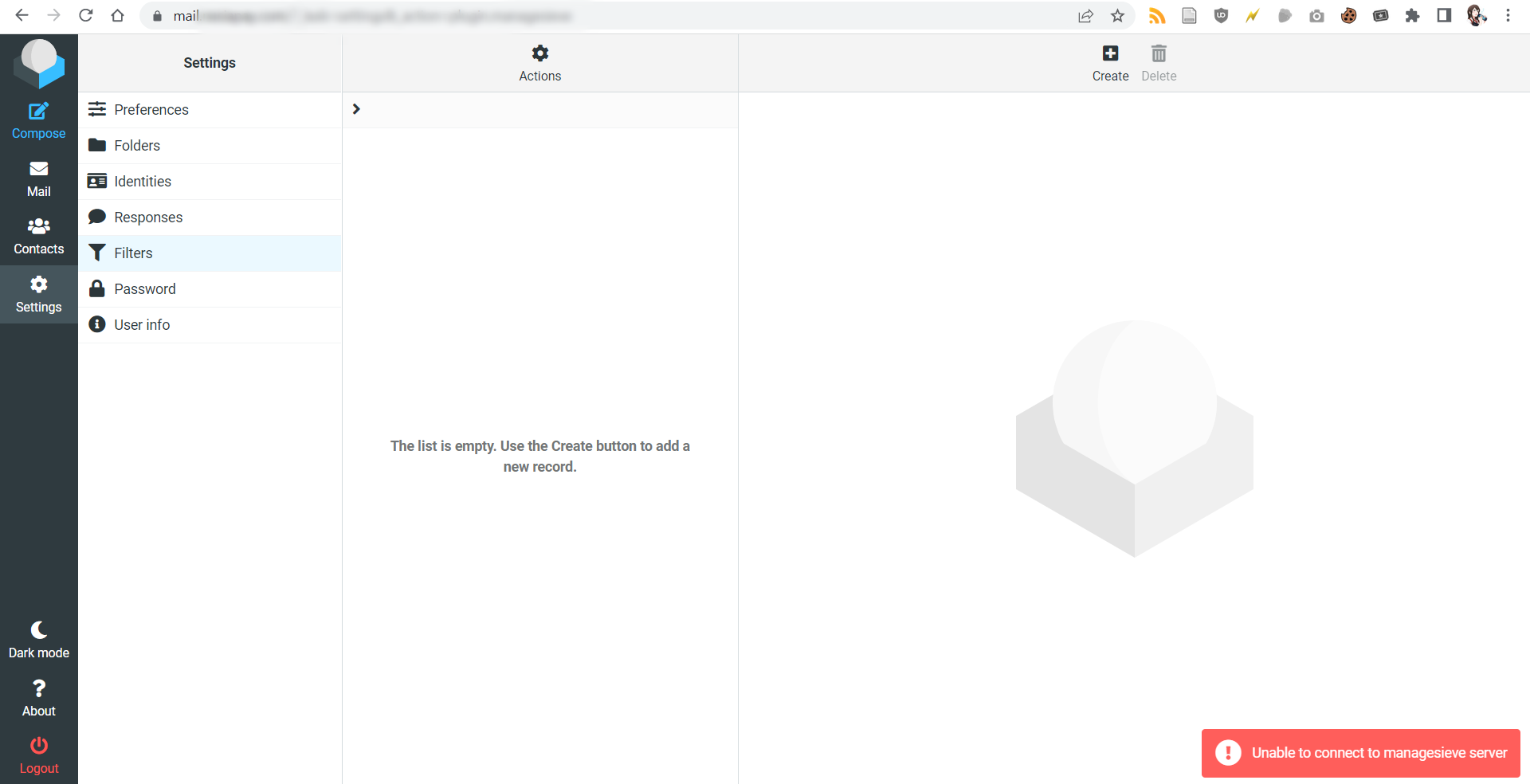

well... on past i already asking about this because of the filter setting on rouncube aapanel didn't works
now it's already 2023 now and some of my friend realize that the error should be on sieve it self...
they said that if i see on the firewall the sive seems not running
does aapanel team had solution for this?
this is crucial system to filter the spam mail based on our setting... for small sites... it's okay to had 1-2 spam email every month
but on my multiple sites... it's pain to skip alot of spam email just to read some urgent mail from my server
i hope i can find any the solution now :')

    HOW TO use mail filter... when error above appear....
    it seems that aapanel on Dovecot config
    in protocols they didn't include sieve
    so just add sive on it... then the error above is solved.....

    aaPanel_Kern umm do aapanel had any "sieve" installed on it?
    if they had... then filtering system from roundcube will do the job....
    can you tell me about the sieve?
    on first time we using aapanel it's good... but sometime after we had alot of visitor
    spammer come and fill the mail...
    that's why i think the mail filter or atleast if you already had sieve... we can solve the issue with roundcube filter setting
    the only problem i see that sieve didn't run/they have no sieve... so how to turn it on?

    I cannot find "little sieve" in the AppStore? I have the same issue mentioned here but the Accepted solution does not give instructions on how to install "little sieve". Any help with detailed instructions would be appreciated. Thanks! 🙂
      2 months later
      aaP_baxant
      if you have debian system
      apt-get install dovecot-sieve dovecot-managesieved
