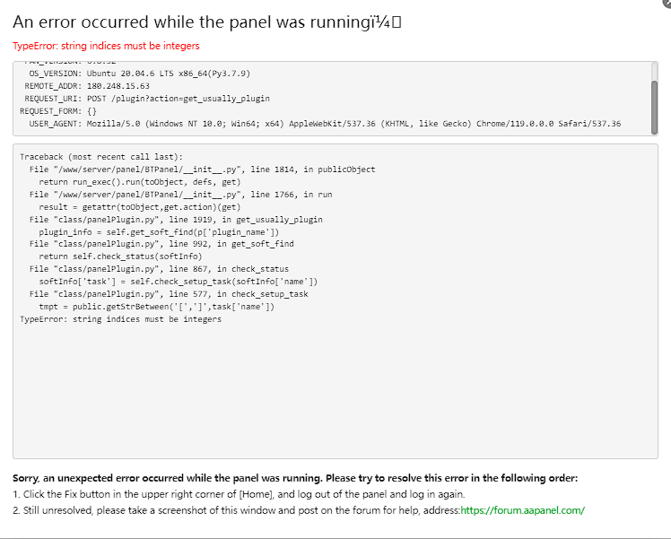

aaP_p2u_bazhou aaPanel_Kern After restart panel and repair panel + restart again, the issue still there. I need the help of panel to install redis and some other software, but i was stuck with this issue for long long time.
aaPanel_Kern aaP_p2u_bazhou Hello, which region is your server located in? Is the server network normal?
aaP_p2u_bazhou aaPanel_Kern Hi Kern, As from previous replied, my server located at Malaysia. network is definitely no issue. my website and other application is working fine. The aapanel other pages except dashboard and App are Ok too.
aaPanel_Kern Hello, is the problem solved? Is it normal to try restarting the panel? Also check if the server can connect to our node server? curl -v https://brandnew.aapanel.com ping brandnew.aapanel.com -c 5 ping google.com -c 5 curl -v http://brandnew.aapanel.com aaP_qiospaycare
aaP_mediadigitalxxi aaPanel_Kern hallo , i had the same problem, i used the code * Could not resolve host: brandnew.aapanel.com Closing connection 0 curl: (6) Could not resolve host: brandnew.aapanel.com Can you help me, because of this error my website is damaged
aaPanel_Kern aaP_mediadigitalxxi Hello,It is recommended to check whether dns is set? cat /etc/resolv.conf If not set, execute the following command to set nameserver: echo "nameserver 8.8.8.8" >> /etc/resolv.conf echo "nameserver 1.1.1.1" >> /etc/resolv.conf
aaPanel_Kern Hello, I suggest you check if you can connect to our node according to the above? Meet_Stefan
