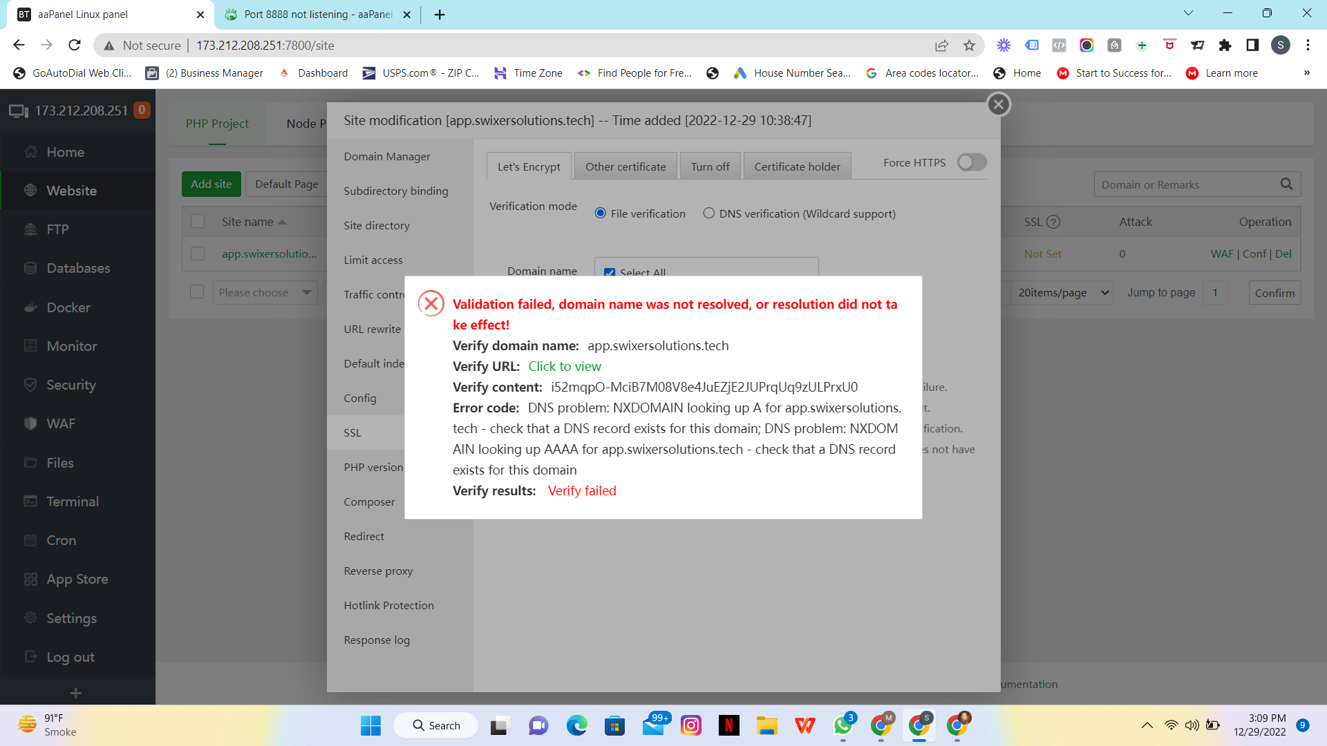

aaP_stalindsouzaaaaa Actually i keep trying to add my doamin to aapanel but it doesnt connect and the prot is not listenning port:8888 is it because of this ? why am i not able to add the domain to aapanel
aaPanel_Kern aaP_stalindsouzaaaaa Hello, aapanel currently uses port 7800. Port 8888 is not used, Can't add domain to panel any info? Is the domain A record pointing to the server's ip? And cannot use proxy.
aaP_stalindsouzaaaaa aaPanel_Kern i have added the a record and pointed it to server ip but it shows me the error of Error code😃NS problem: NXDOMAIN looking up A for swixersolutions.tech - check that a DNS record exists for this domain; DNS problem: NXDOMAIN looking up AAAA for swixersolutions.tech - check that a DNS record exists for this domain
aaPanel_Kern aaP_stalindsouzaaaaa Are you using a dns manager? Or the domain name provider's website? It is recommended to use the domain name provider's administration website.
aaP_stalindsouzaaaaa aaPanel_Kern i'm using domain name provider administration website but still it doesn't work
aaPanel_Kern aaP_stalindsouzaaaaa Use this website to check the parsing of the A record https://dnschecker.org/all-dns-records-of-domain.php
aaPanel_Kern aaP_stalindsouzaaaaa Did you add a record? You are advised to consult the domain name provider
aaPanel_Kern aaP_stalindsouzaaaaa Did you add a record? You are advised to consult the domain name provider ???
