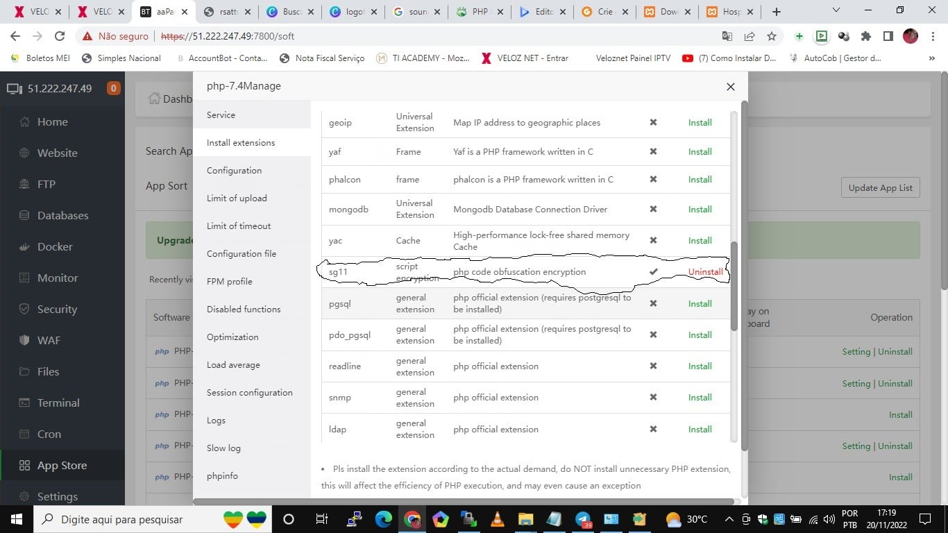

Gostaria de sabe como faço pra instalar o SourceGuardian nesses php pois ja instalei no 7.4 so que o mesmo não ta carregando e o scritp que to usando requer o php8.0 ou 8.1 com SourceGuardian fico no aguardo

Hello, do you want to install extension sg11 in php7.4?
ola ele até instalar mas não ta carregando estou executando um script e o mesmo informa que o soundguard não carrego e vejo no phpinfor informa que não ta ativo fica no

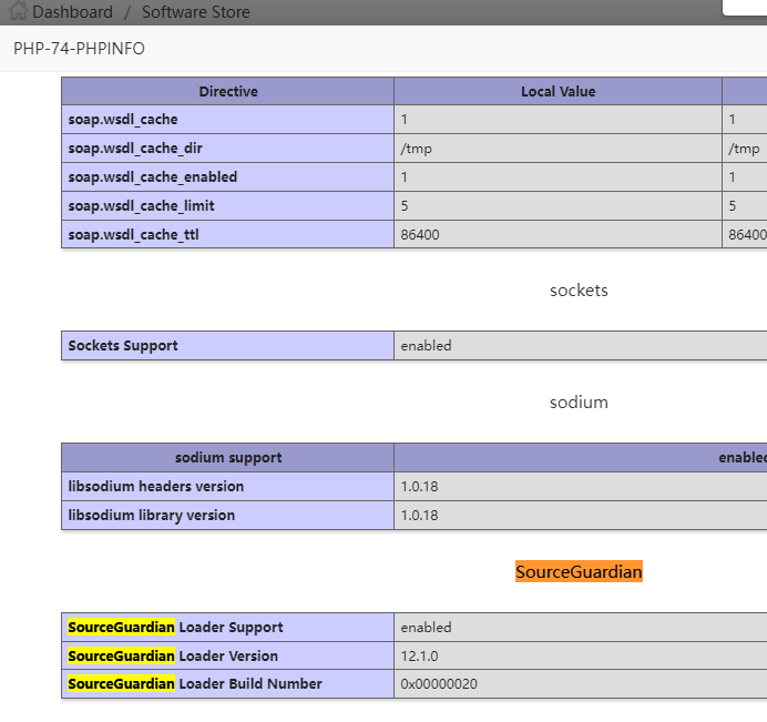

aaP_renatorobson9
Hello, try to use View phpinfo() to check whether the installation is successful

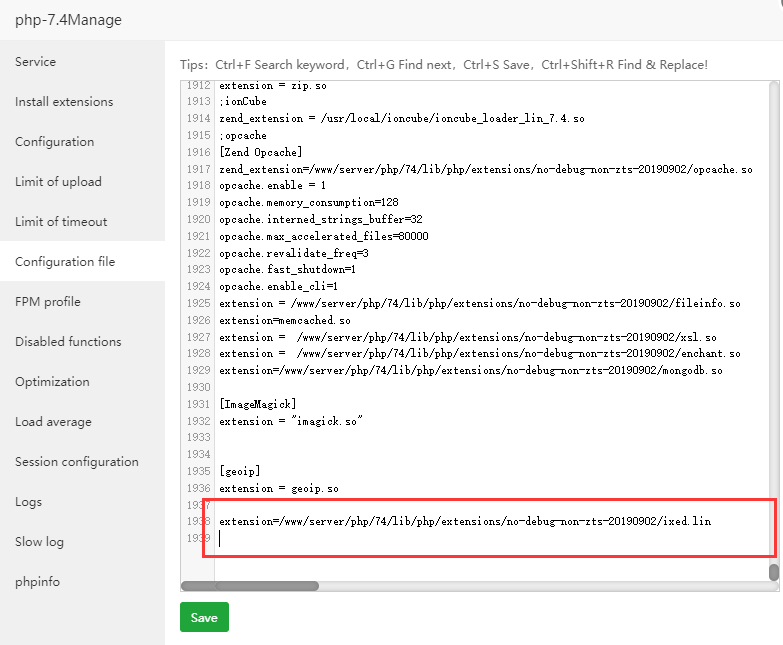

fiz o procedimento que você mim orientou tentei da restar mais tava dando erro ai dei stop e fui star deu esse erro aqui php 7.4 como resolver esse erro não ta startando
Warning message:
[19-Apr-2023 00:17:34] NOTICE: PHP message: PHP Warning: PHP Startup: Unable to load dynamic library '/www/server/php/74/lib/php/extensions/no-debug-non-zts-20190902/ixed.lin' (tried: /www/server/php/74/lib/php/extensions/no-debug-non-zts-20190902/ixed.lin (/www/server/php/74/lib/php/extensions/no-debug-non-zts-20190902/ixed.lin: invalid ELF header), /www/server/php/74/lib/php/extensions/no-debug-non-zts-20190902//www/server/php/74/lib/php/extensions/no-debug-non-zts-20190902/ixed.lin.so (/www/server/php/74/lib/php/extensions/no-debug-non-zts-20190902//www/server/php/74/lib/php/extensions/no-debug-non-zts-20190902/ixed.lin.so: cannot open shared object file: No such file or directory)) in Unknown on line 0
[19-Apr-2023 00:17:34] ERROR: Another FPM instance seems to already listen on /tmp/php-cgi-74.sock
[19-Apr-2023 00:17:34] ERROR: FPM initialization failed

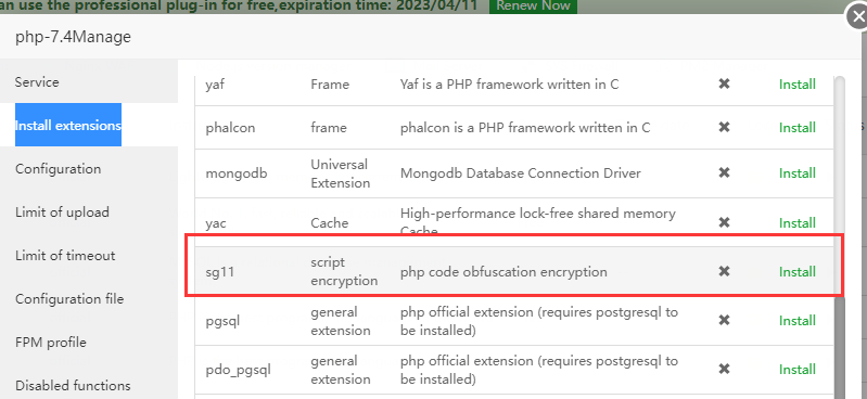

The ixed.lin file does not exist. It is recommended that you delete the relevant configuration and reinstall the sg11 extension
