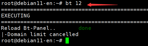

aaP_lapaktelur_com Hi, I just set up panel domain and hence I can't access panel using ip:7800. How do I disable the panel's domain, so that I can access the panel by ip again?
aaPanel_Kern aaP_lapaktelur_com Hello, is the problem solved? Use the SSH tool to log in to the server to execute the command to cancel the domain name: bt 12

aaPanel_Kern Is it normal to use the correct link to visit? The bt 14 command can view the link aaP_shresthalokesh
