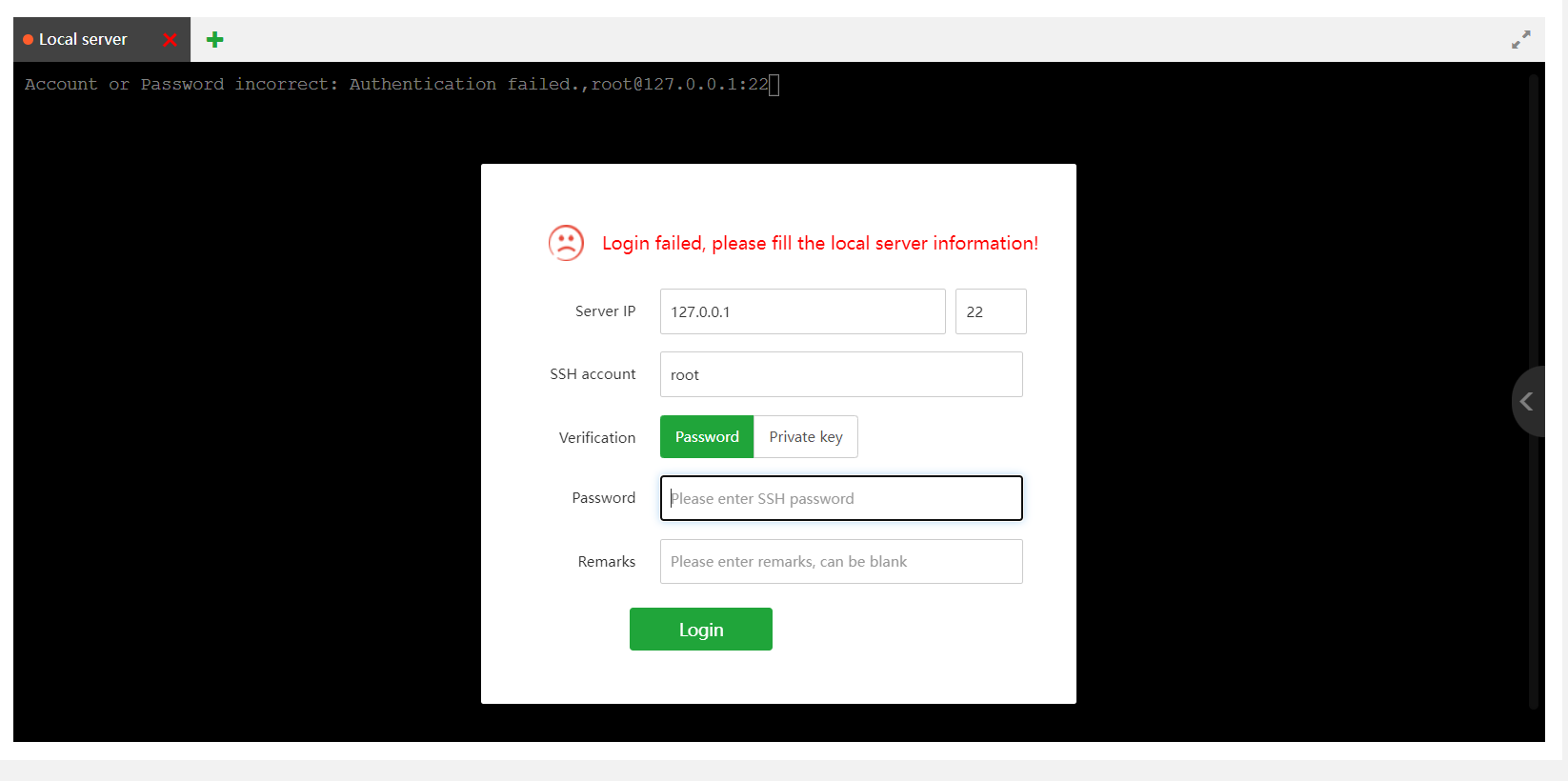

This is what it shows when i open terminal
Then i put in my info
I press login and it shows this
And then back to here

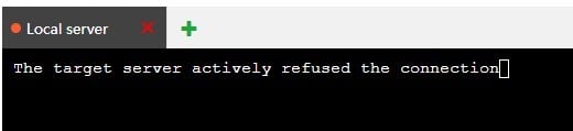

FYI :
andiafri
The server rejected, what was the reason for the check. Check whether there are prohibited IPs in this file?
cat /etc/hosts.deny
