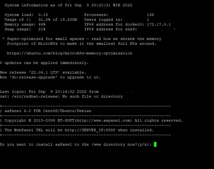

Hi,
I have done the installation, and have been using it for the last 1 week, have modified a few things. But when I access the VPS using PuTTY, this display always appears.
Usually, I install aapanel manually. But now I'm trying to use the direct install feature via the one-click installation feature of the hosting that I'm using. Is there a way to get rid of this?

      Hello, where did you buy your server? How did you install aapanel?
      This file will be executed once if the user logged in successfully.
      /etc/profile.d/99-init-boot.sh
      /usr/bin/aapanel-install
