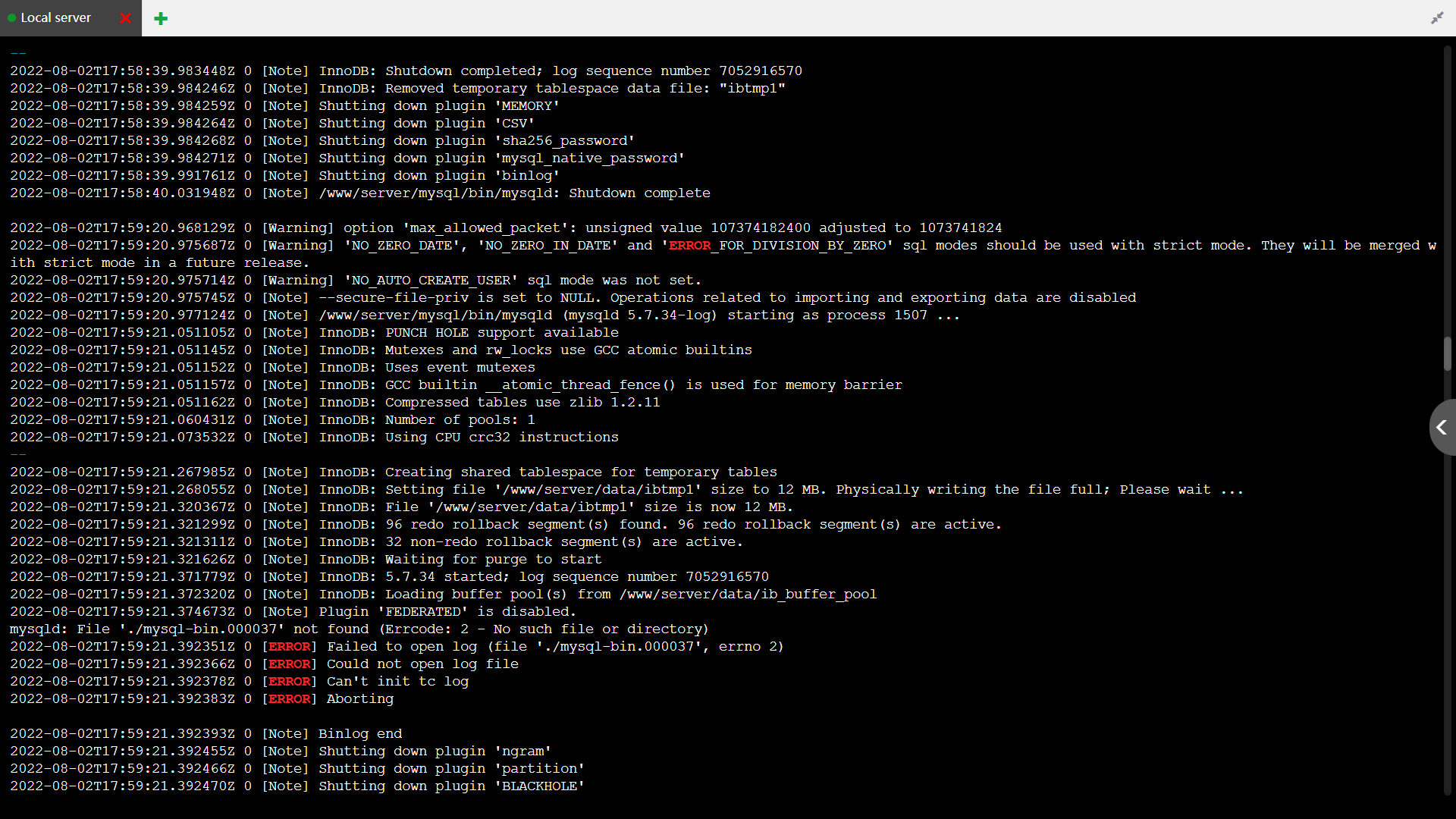

Deleted mysql-bin.000037 from the /www/server/data/mysql-bin.index file.
Restarted MySQL. Didn't help
As I understand server can't connect to MySQL,

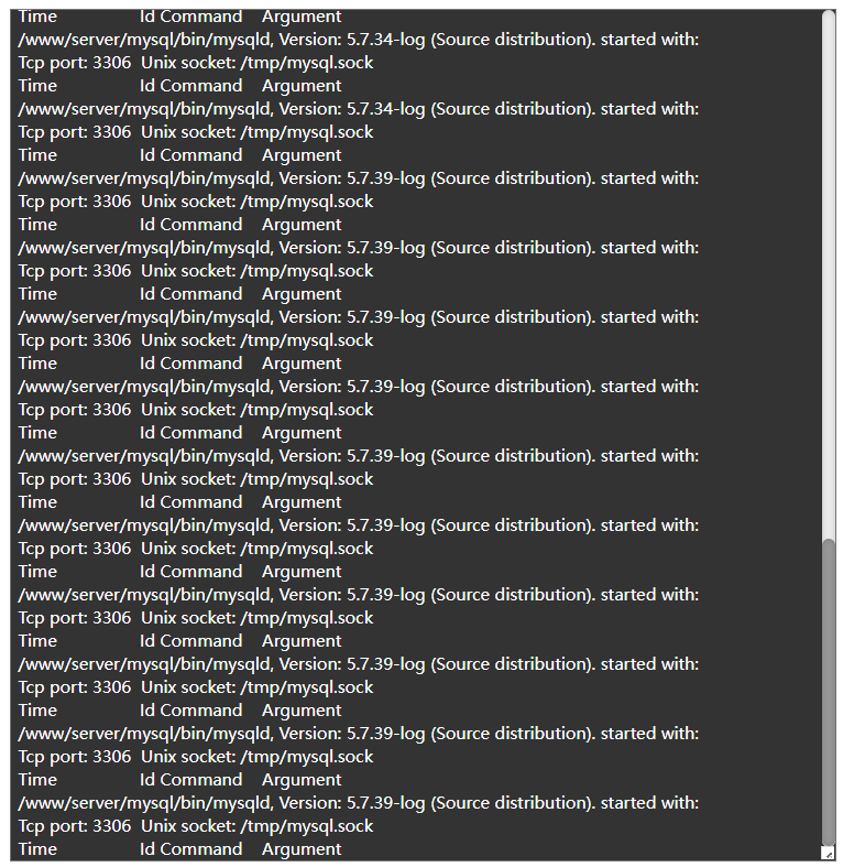

    Execute the command to see what errors are displayed in the mysql log
    cat /www/server/data/*.err|grep -i -C 10 error

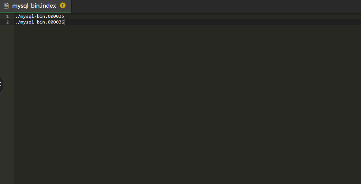

        Check out what mysql-bin files are in your directory, and can you tell me what you have done before?
        ls /www/server/data/mysql-bin*
          decen
          Execute the command check out what mysql-bin files are in your directory
            decen

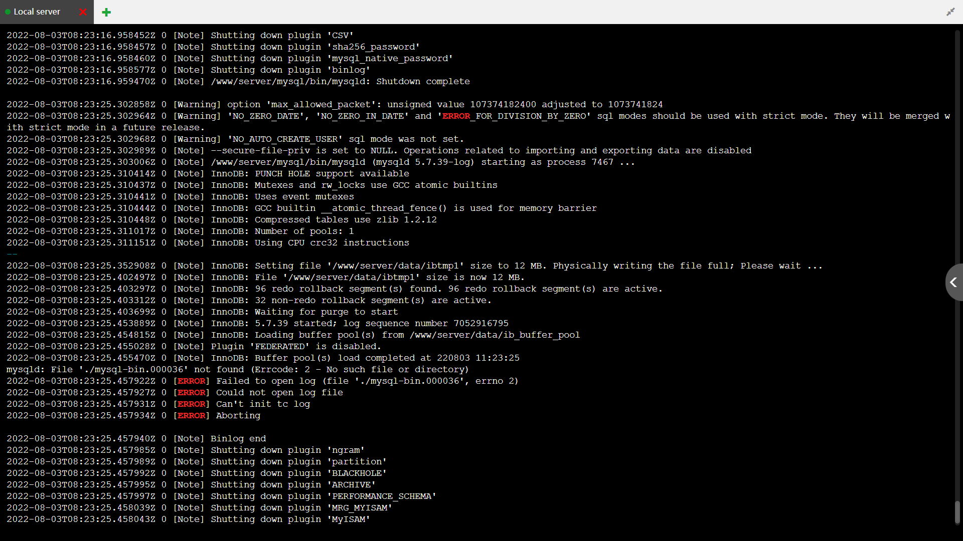

            There are no mysql-bin.000037 mysql-bin.000036 mysql-bin.000035 files in this directory.
            Try to remove the file mysql-bin.index and restart mysql
            mv /www/server/data/mysql-bin.index /tmp/mysql-bin.index
            /etc/init.d/mysqld restart
              Solved! Everything works perfect.
