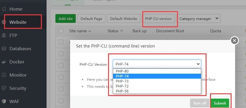

If it is normal, please go to the panel to reset "PHP CLI Version" to PHP-81
Execute the command again:

Hello, try to un-alias, and then set PHP-ClI on the panel
unalias php
