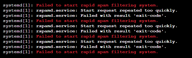

aaP_engr_irfan641 and if you are saying to reinstall the os ubuntu sorry I can't reinstall because websites are hosted on the same server.
aaP_engr_irfan641 no during installation there was no error at the end there was just one thing rspamd stop nothing else
aaPanel_Kern aaP_engr_irfan641 Is to reinstall mail is not ubuntu system. Is it normal to use the ssh tool to execute the command /etc/init.d/rspamd status /etc/init.d/rspamd start
aaP_engr_irfan641 yes i am using mobaxterm for ssh and result of the command is still same I have tried all these normal methods
aaPanel_Kern aaP_engr_irfan641 Hello, try the following command: sudo apt remove rspamd -y CODENAME=lsb_release -c -s sudo mkdir -p /etc/apt/keyrings wget -O- https://rspamd.com/apt-stable/gpg.key --no-check-certificate| gpg --dearmor | sudo tee /etc/apt/keyrings/rspamd.gpg > /dev/null echo "deb [arch=amd64 signed-by=/etc/apt/keyrings/rspamd.gpg] http://rspamd.com/apt-stable/ $CODENAME main" | sudo tee /etc/apt/sources.list.d/rspamd.list echo "deb-src [arch=amd64 signed-by=/etc/apt/keyrings/rspamd.gpg] http://rspamd.com/apt-stable/ $CODENAME main" | sudo tee -a /etc/apt/sources.list.d/rspamd.list apt-get update export DEBIAN_FRONTEND=noninteractive apt-get --no-install-recommends install rspamd -y wget -O /usr/share/rspamd/www/rspamd.zip http://128.1.164.196/install/plugin/mail_sys_en/rspamd.zip -T 5 --no-check-certificate cd /usr/share/rspamd/www unzip -o rspamd.zip /etc/init.d/rspamd status /etc/init.d/rspamd start
aaP_engr_irfan641 aaPanel_Kern still result is same i can provide you access of ssh if you can share you key and in the result of above command here is the result
aaPanel_Kern aaP_engr_irfan641 Hi, can you give us your aapanel information? If possible please send to kern@aapanel.com. It is recommended to fill in the following Post link: SSH account password and port: aapanel login link address and account password:
aaPanel_Kern Hello, the problem with the hosts file has been dealt with rspamd uses the localhost monitoring port Just uncomment 127.0.0.1, as shown in the figure:
