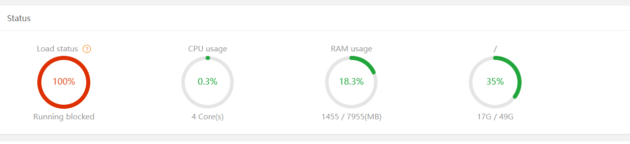

aaP_uby777881 I have only 1 website and it shows 100% in 6vcpu and 16vcpu. Is it a DDos attack? How can i prevent this attack?[upl-image-preview

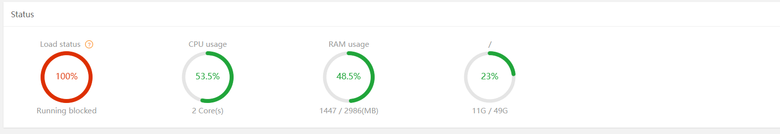

MrHades My server loads 100%, I'm streaming video from my server, how to optimize it better, I have a lot of free CPU and Ram Could you help me please?
aaPanel_Kern MrHades Hello, io shows 99.99%, are you using ssd? It seems that the speed of the hard disk can't keep up with your website access
adis0308 aaPanel_Kern How do I ward off a DDOS attack? Because I have tried the SYS Firewall and Fail2ban applications but those applications can't block the attacks that occur.
aaPanel_Kern adis0308 Hello, DDOS attack software is difficult to defend against, if it is DDOS, you can find a service provider

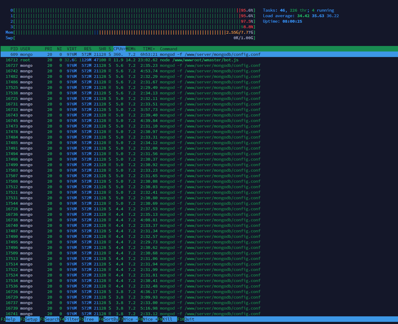

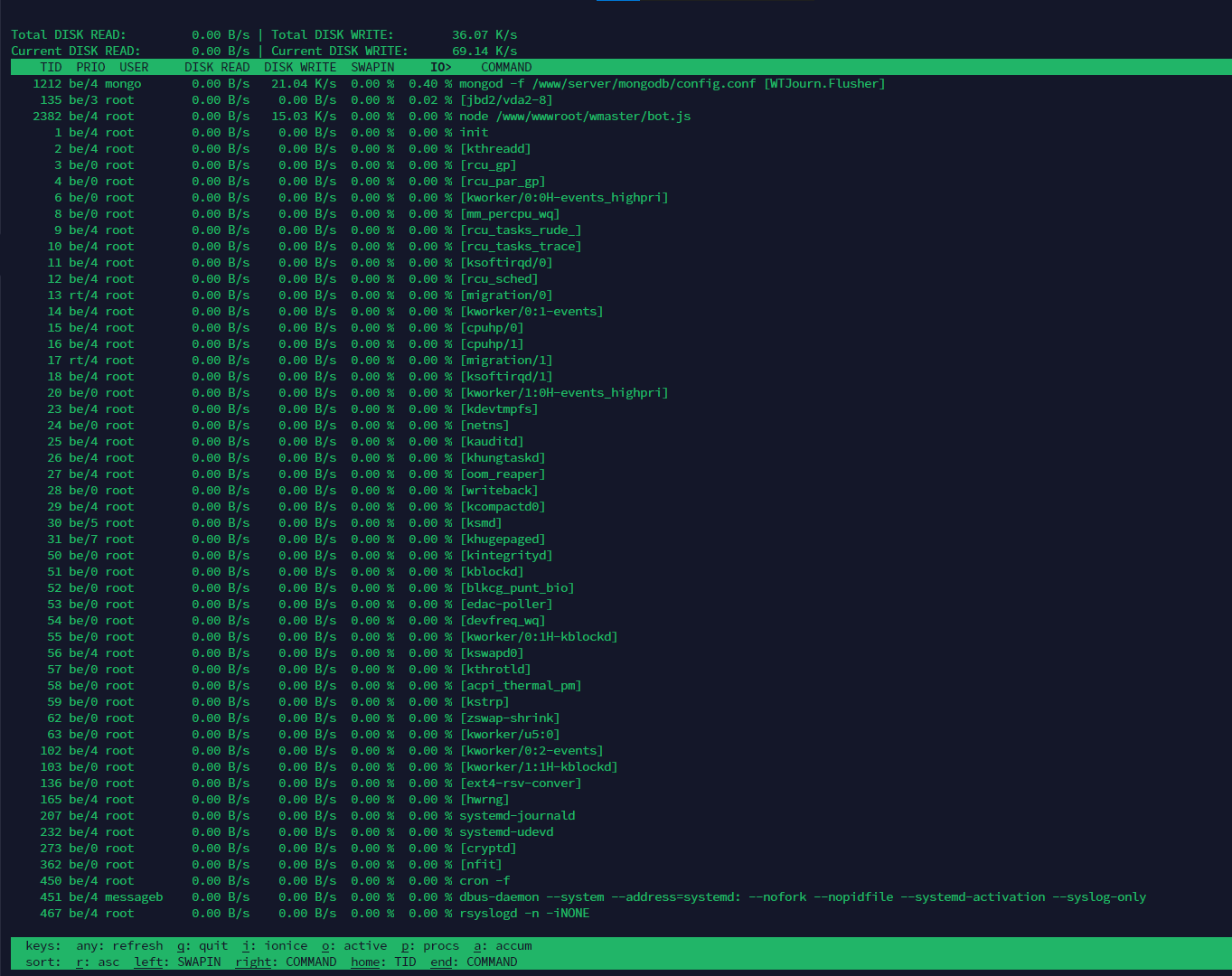

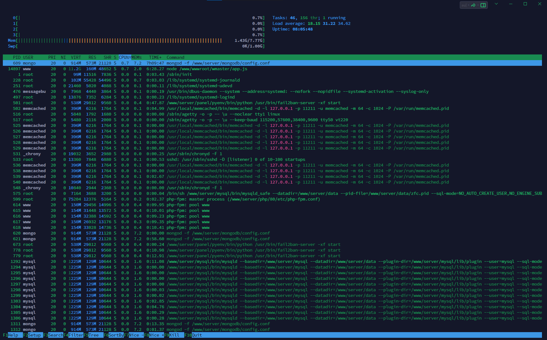

aaP_mdervisaygan aaPanel_Kern Hi, I'm having a lot of problems with my server, sometimes it locks up. System😃ebian GNU/Linux 11 x86_64(Py3.7.9)

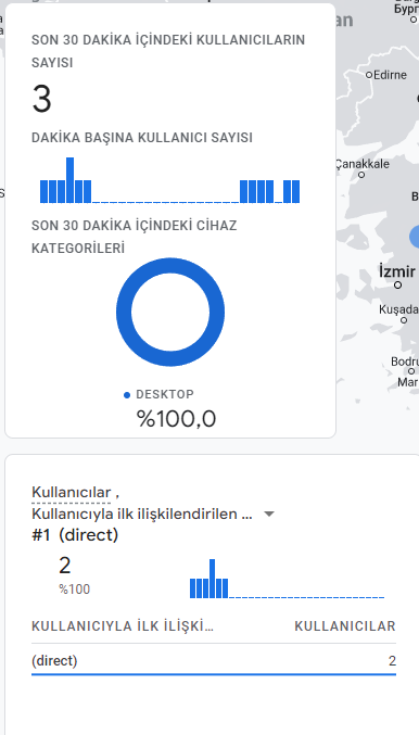

aaP_mdervisaygan aaPanel_Kern I am grateful for your response and for this excellent panel you have provided free of charge. I left below the details you asked for. Is it normal for mongodb to use so many resources and fill io when there are 4 users on the site? What should I do? I increased the server power to 4 cpu 8 ram and it's still the same.
aaPanel_Kern aaP_mdervisaygan It is recommended to check the log of mongodb and check whether the log of the website is normal
