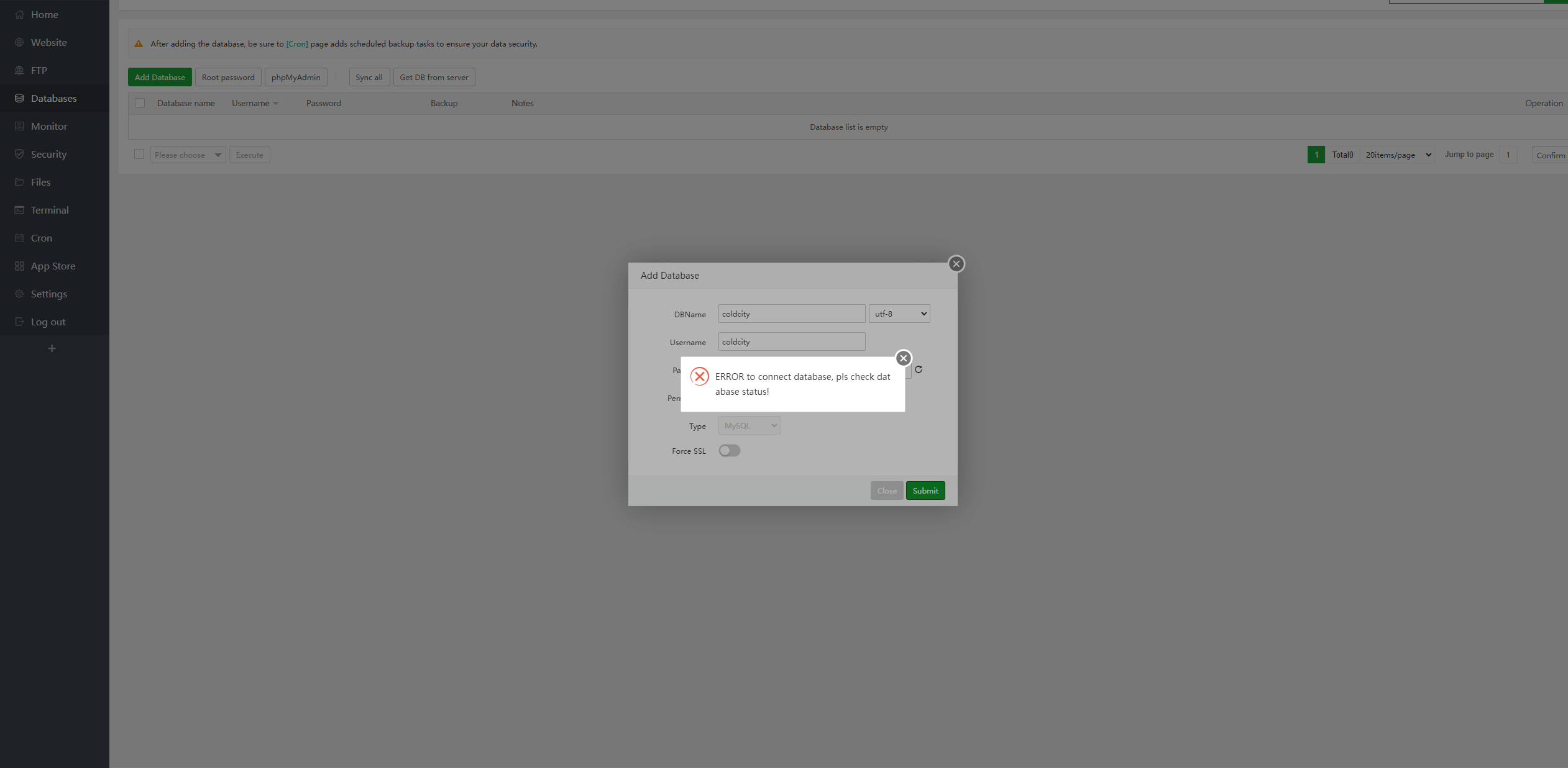

MrSeKay Hello when I want to create a Database ( my first ) this error happening,. what can i do to solve it? I have already tried all (unless I missed) the solutions posted on this forum, please help me
aaPanel_Jose MrSeKay Please check if your mysql status is running Try to reset the mysql root password

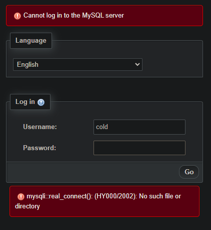

MrSeKay aaPanel_Jose Thanks, now it's working, but when i want to connect to my php this error happening ? do you have other advice ?

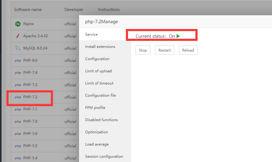

aaPanel_Jose MrSeKay Please check whether the php program used by your phpmyadmin is running normally?

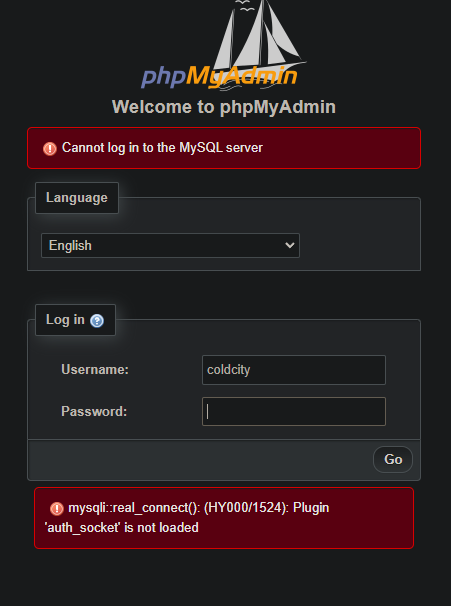

MrSeKay Yesss, now it's working ! But I have again an error 😅, when i register my self this error happening :

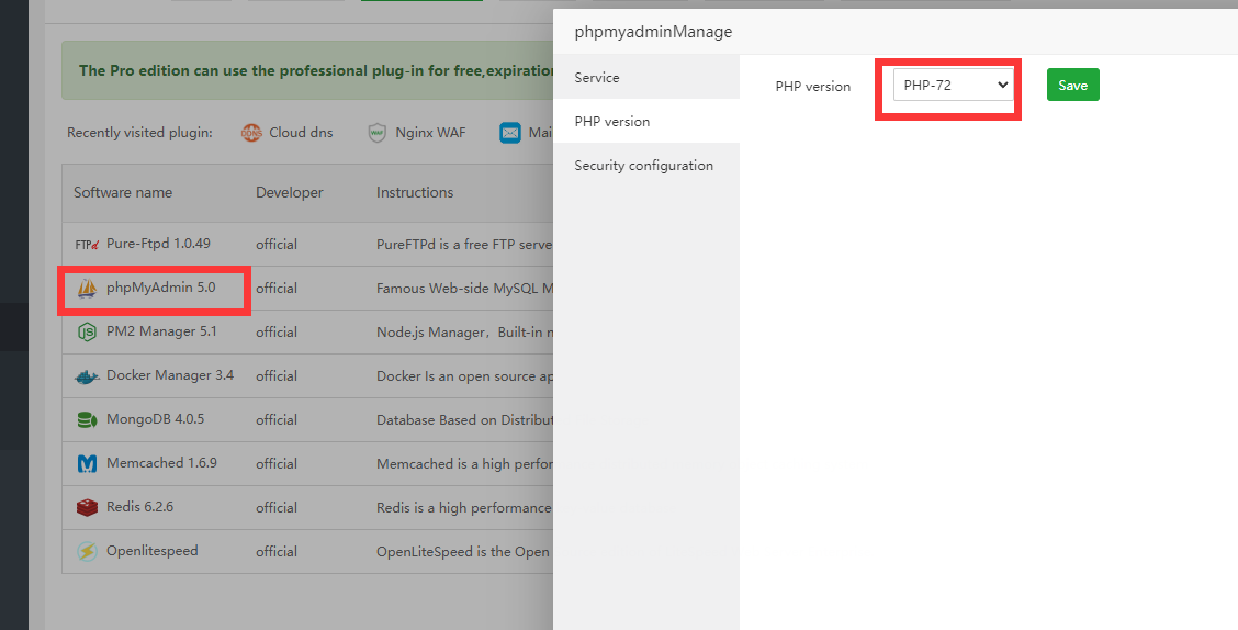

aapanel_power MrSeKay Hello, you can replace the php for 7.4 phpmyadmin version to 5.0. See if it works?
TrK The error only occuers if configuerd incorrectly i will recommend you to remove the MySQL server and re-install it to see if it works or not. Don't forget to backup any database you have.

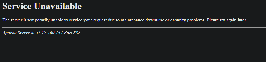

MrSeKay TrK sorry I just checked and the error was finally not the same, here is the news Do you have any ideas ?
aaPanel_Jose MrSeKay if you can please send you panel login info to jose@aapanel.com we will check this problem for you
