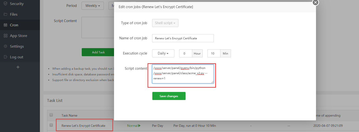

The auto renew of letsencrypt certificates is not working on my panel. I think this is due the /www/server/panel/vhost/cert/crontab.json file, because it is empty. Is there a way of re-generating this file?
    The_Markus
    Hello, this correct renewal script, you can try it
    /www/server/panel/pyenv/bin/python /www/server/panel/class/acme_v2.py --renew=1
